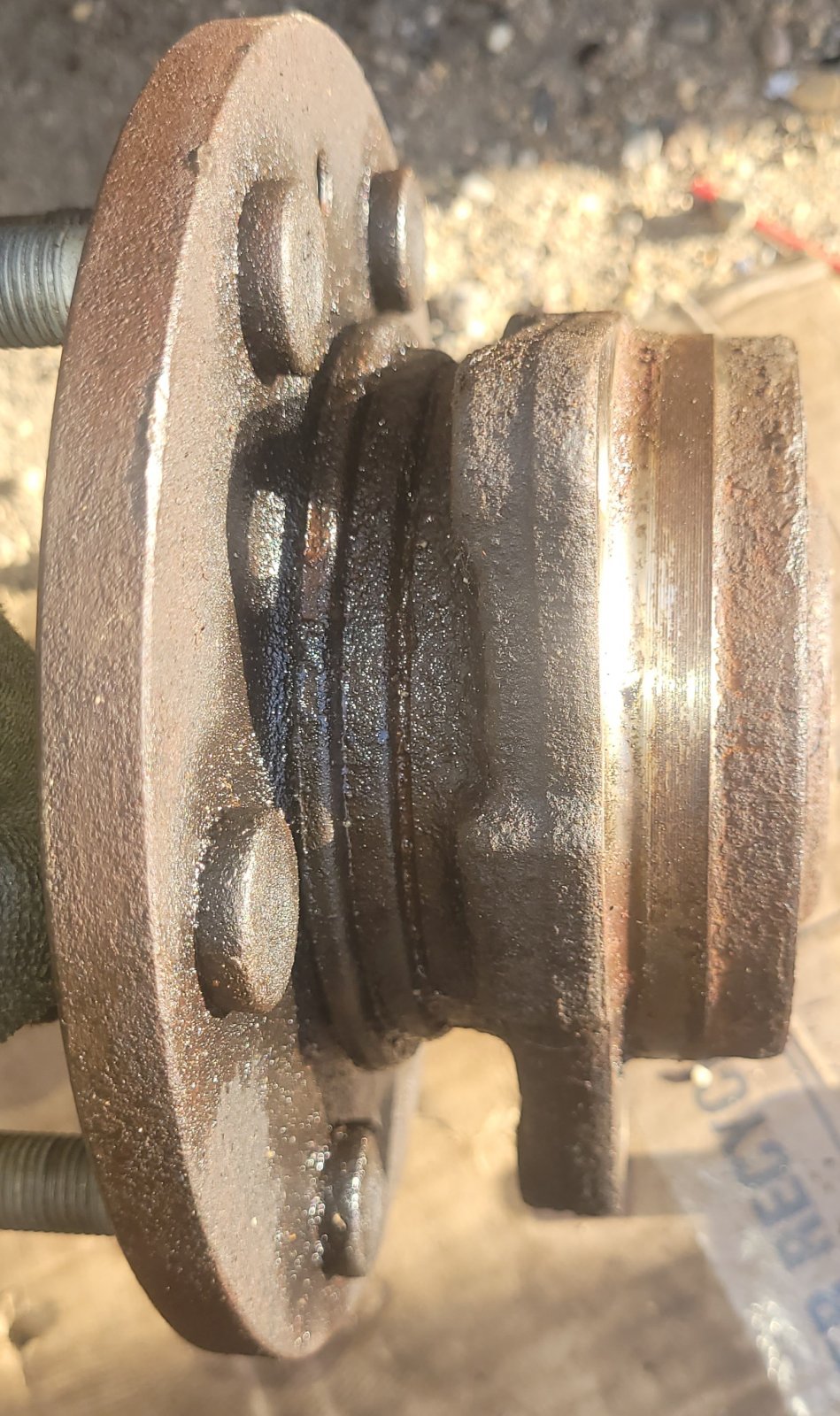

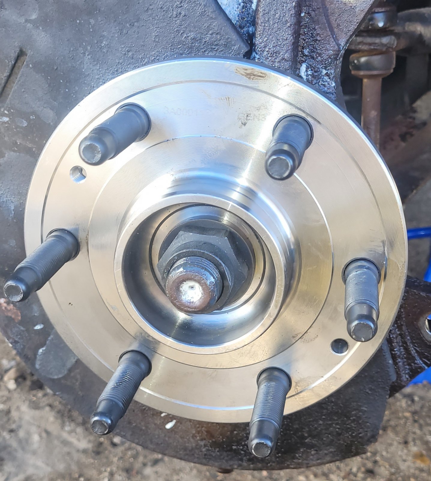

Changed front hub assembly..went smoothly until a bolt decided it was happy staying put, it was awkward to get at with my Impact as well.
Managed to get an extension on my Impact which after a few attempts managed to get it moving. Hub came off after a few gentle taps with my fine adjusting tool
Replacement was a mevotech upgraded unit with new bolts and hub nut.
Free shipping within Canada was a bonus. I used Thewrenchmonkey.ca ( for anyone else up north).
It was making grinding noise when i turned it by hand. Other side isn't making noise yet so I'm not changing it. Took a bit longer than expected due to the bolt and searching for.my torque wrench.
We changed both hubs at buddys shop. I figured once up in the air do both.
