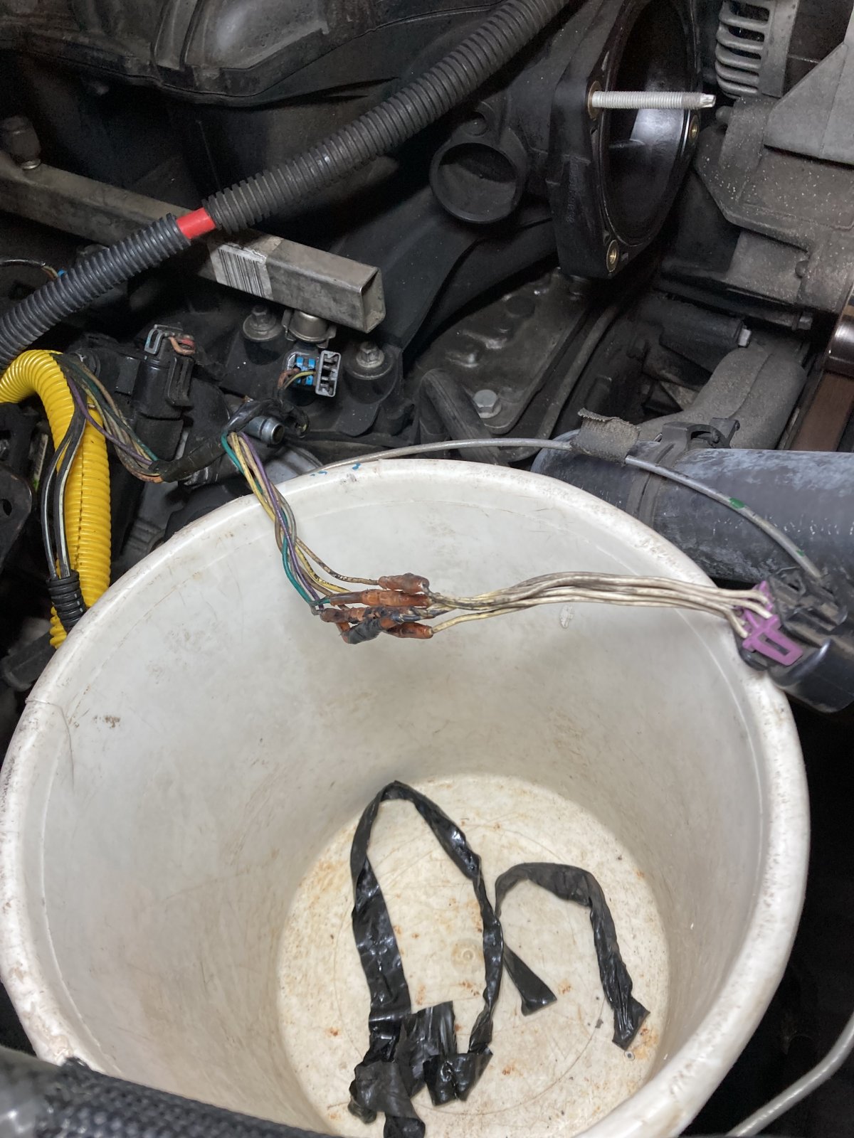

It's a wire harness in a dynamic environment. A problem occurring by touching it even once is too many times. Not saying that was the problem, but a problem. I hope the shop finds a smoking gun.

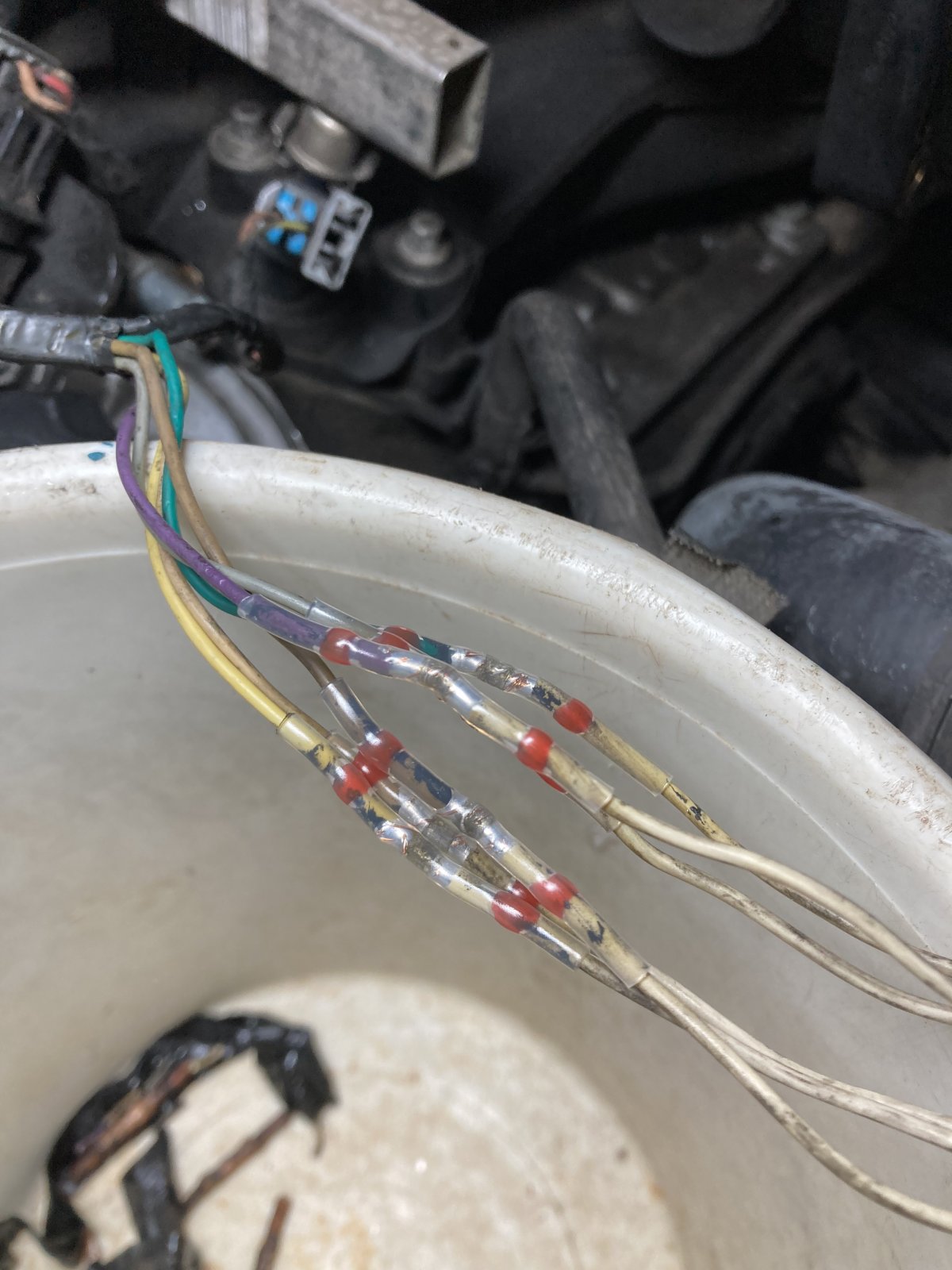

Well I watched several videos and they all said the TPS has to be installed with the throttle plate in WOT position which I did not do. I am going to bring the truck back home and make that correction. Then I am going to try to follow the harness back a reasonable amount to try and find any wiring issues. Then I will drop it back off at the shop and see what happens.

you no listen when I say you gots bluetooths wires goings on…
Sorry pawpaw I hope that’s it buddy
I re soldered the connections and re-installed the TPS on WOT. Started up and ran fine. Still took it back down to the shop to have their computer take a look at things. Still afraid to drive it just because of this random revolving limp mode crap. I'm hoping to hell my last efforts here were not in vain.
