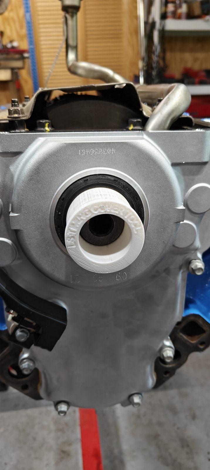

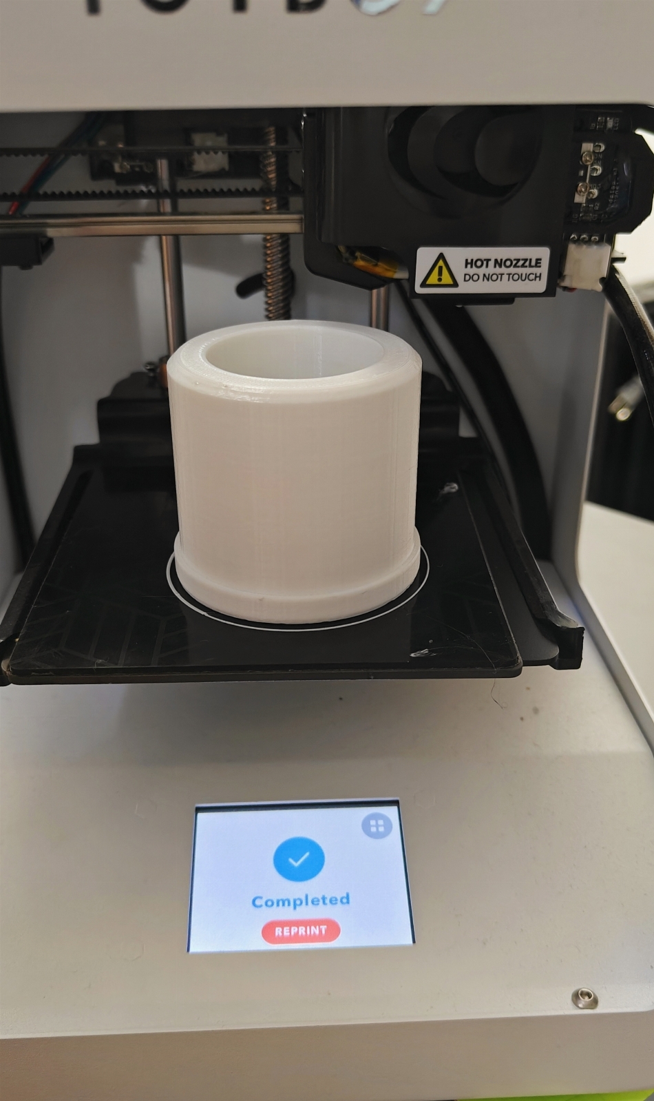

Made a thing to center the front timing cover. The kids don't use their little toy 3D printer, so I fired it up with a ThingVerse .stl, and made the overpriced tool for free.
View attachment 431061View attachment 431062
EDIT: Also, the new harmonic balancer just arrived. Now I'm just waiting on the oil pickup tube clamp to button up the front of the engine.
