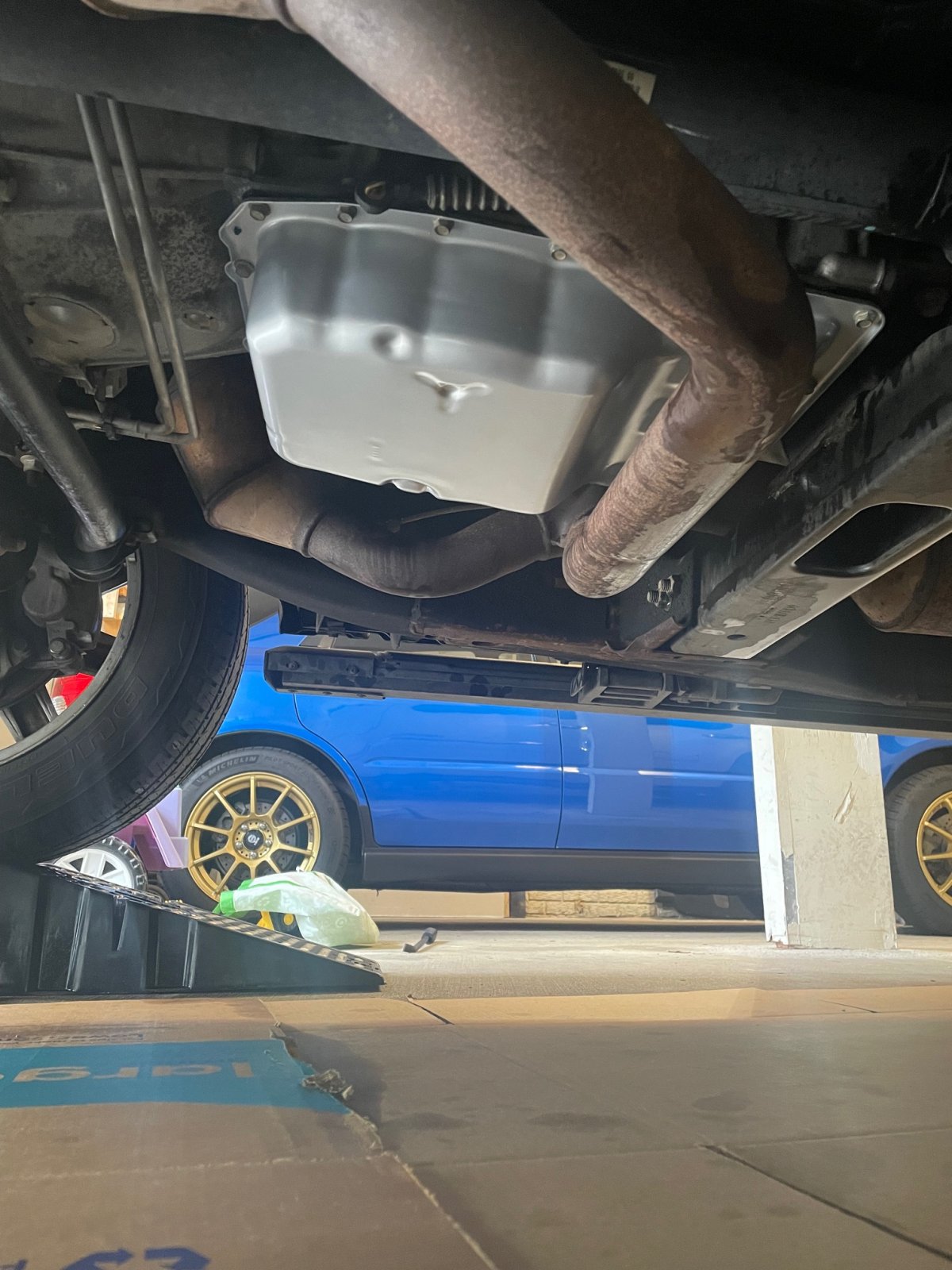

Changed the trans fluid on my '14 over the past ~24 hours. I was fairly clean until it came time to flex the exhaust pipe out the way to get the back end of the pan out LOL. I followed a YouTube video, but will note on my '14 I did not have to remove the shift cable linkage; it was not blocking access to any of the trans pan bolts.
18, 10mm bolts hold the pan on. I removed the gasket prior to fiddling with flexing the exhaust pipe slightly to slide the rear of the pan out.
I elected to not fool with the metal retainer ring that holds on the trans filter. I just pushed up in there my new one. I used the OEM ACDelco filter, fluid, and pan gasket.
Fluid had clearly been changed before by PO, as the magnet was quite clean (pic below) and the bolts + old gasket came off no troubles. Cleaned and painted the pan while off with Rustoleum Enamel spray can (silver).
On re-install, I found it easier to twist the pan up and into position, THEN I slipped the pan gasket through and on. The gasket on initially with pan was too thick to get past the exhaust piping. I got about 5.5 quarts + whatever residual in old filter (so nearly 6?), out of the system by doing this.
