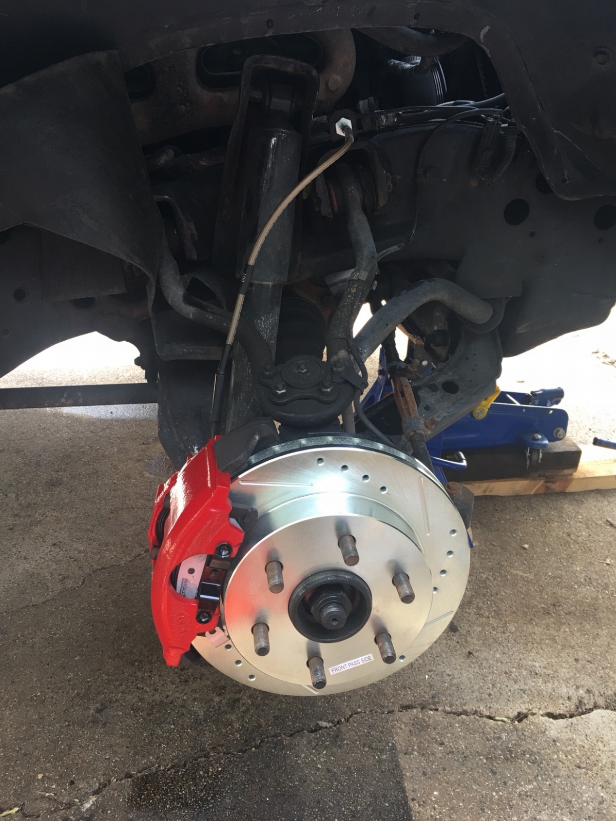

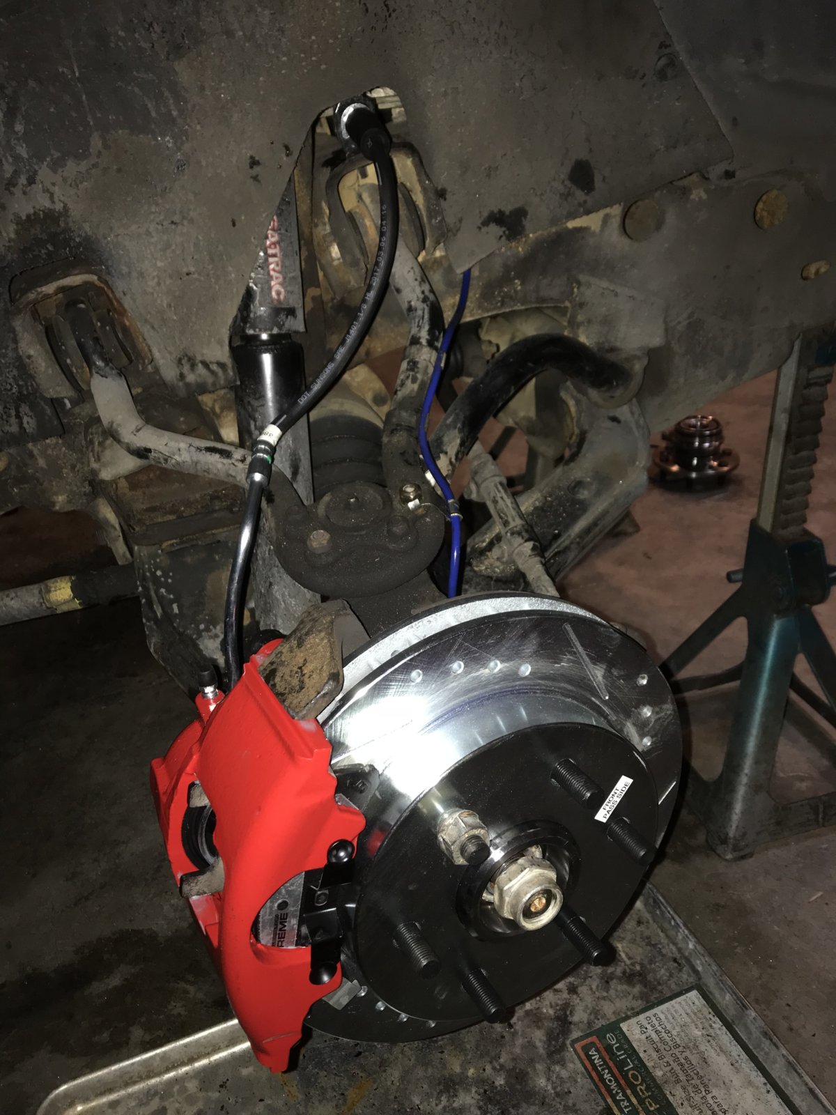

swapped in my NBS master cylinder.
AWESOME!!!!! I recommend this to everyone with the squishy OBS brake pedal.
My pedal is now very firm.:peace:
You need an AGS BLF-26C brake line adapter from AutoZone and obviously a NBS 1500 series master cylinder.
bleed the master cylinder against a tire stop :lol:
No other modifications needed to fit NBS MC?
