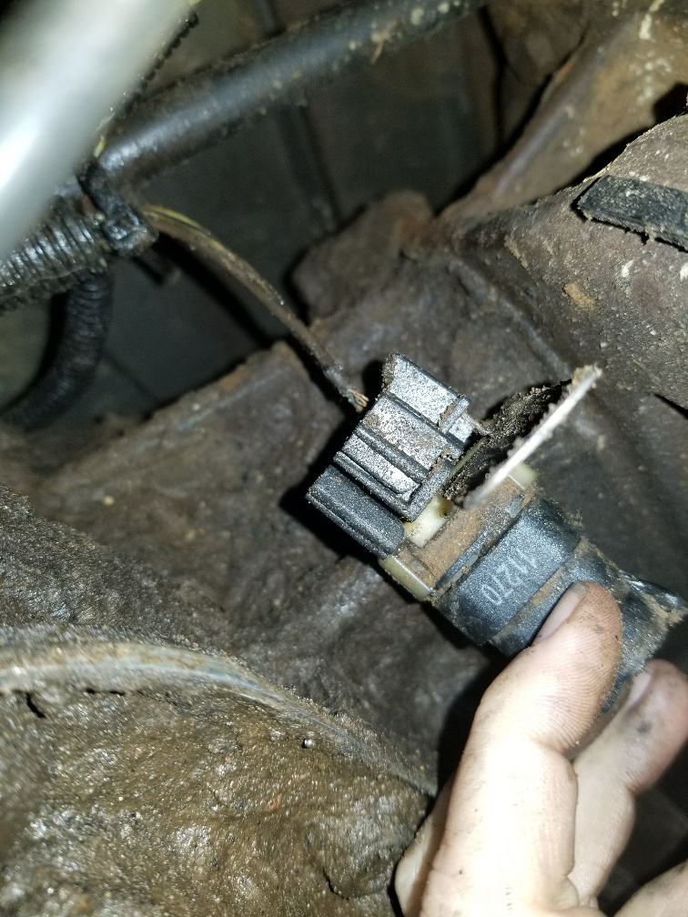

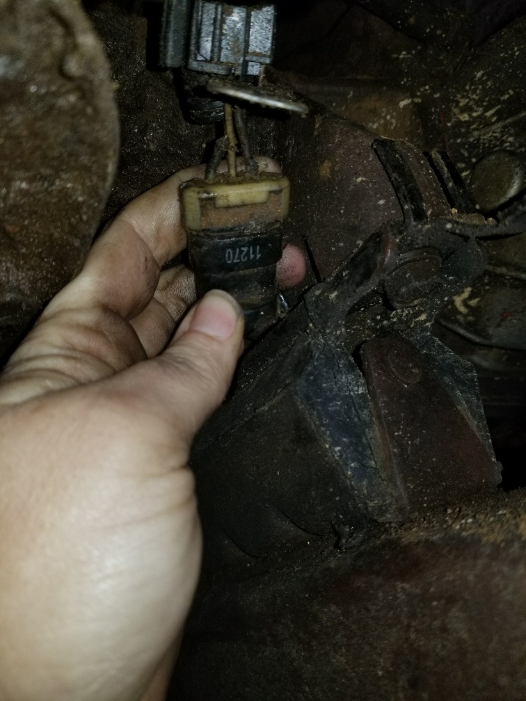

Working on the Denali as as we speak. I set out to change the spark plugs and wires, diagnose and replace EGR if necessary, and check the CMP harness before I decide to change the sensor.
So far, I've changed the EGR (Will post pics later or the old one. It was toast), and discovered that the cam position sensor WASN'T EVEN PLUGGED IN.
Gonna go ahead and reassemble the distributor cap and rotor, change out the plugs and wires, and take her for a spin.
Maybe I'll probe the wires for my fuel sender afterward, to determine whether its a simple wiring fault, or a sensor fault.
