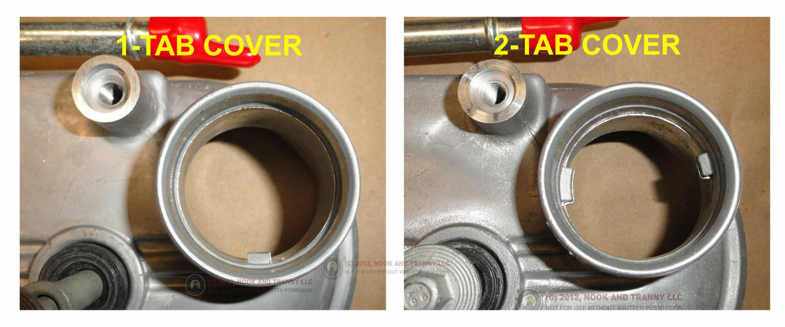

stock cap didnt go into the valve cover, holley did
but i cant recall which one had 1 tab or two lol i'll check when i get home
*** looking back thru thread on pt.net i needed a cap with two indents, meaning my stock one only had one indent

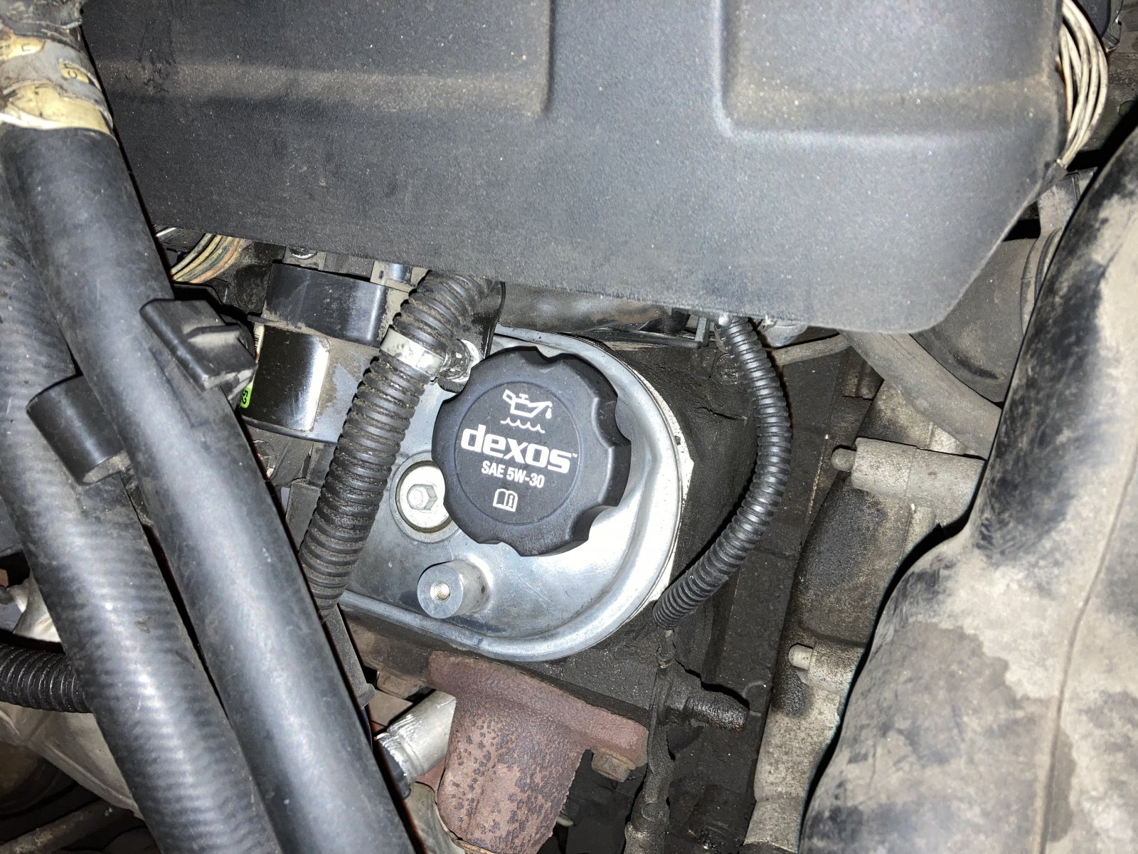

Does your tube "tilt" up and out like I am or does it stay tight and flush to the cover?
never had any issues with it.
i dont use the tube anymore but im thinking mine had 2 tabs and the oil fill cap only had one tab, thus i couldnt put it directly into the valve cover.
