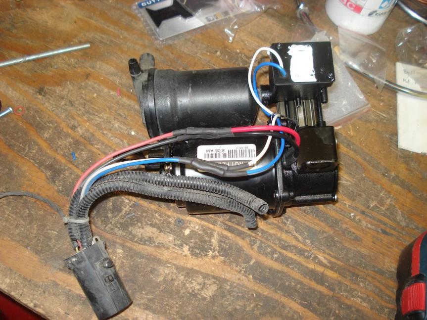

I know this is a tad late, but hopefully the OP can read it before he pulls the trigger on some remanufactured shocks. Monroe has a replacement shock, PT# 40034, for the Z55 trucks that runs about $250/ea. I replaced the ones on my Yukon with those and they are an excellent part. The fuse you are looking for to keep the compressor from running is the Real Time Damping (RTD) fuse under the hood.
Also, you mentioned you never heard the system release pressure. I'm not sure about all trucks, but I've noticed that with mine you can hear the system release pressure a little while after the load has been removed and the truck has been turned off.

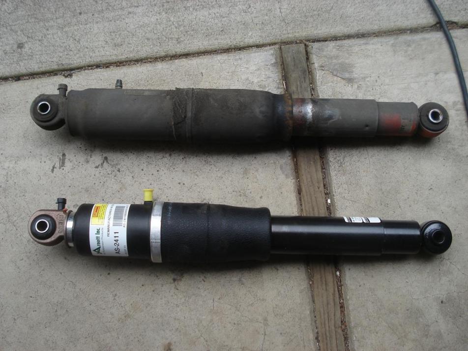

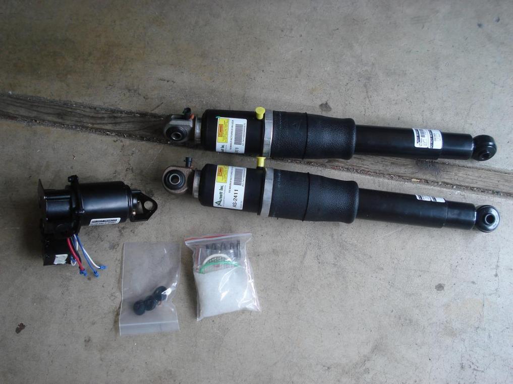

These are the shocks I'm looking at buying, either the new bilstein ones or their reman'ed OEM ones that they sell, I also like the fact that they are a lifetime warranty on them (that's also saying that if they are still in business if they ever fail!! :) ). I'm not looking for any taller riding spring so if that's all the Z ones will raise the rear, then I'm gonna have to look into those!! Do you know of a good place to buy those Matt? Was also thinking about putting the compressor on a switch as well Matt, that is indeed a good idea in case a shock blows or the compressor is having to work too hard!! Like I mentioned, I tow a tow hauler but it's not very often, but just enough to like having the air ride on my 1/2 ton denali!
Also, Arnott has a few package options on Ebay for the different shocks/ compressor options and I'm trying to figure out what all I want to buy from them to figure out what package deal I want!! My dad can get pretty killer deals on GM OEM stuff through his work so trying to figure out what path I wanna do! Thinking about doing the rear reman OEM shocks and compressor package deal on Ebay and buying OEM fronts from my dads work, that way I still have the factory dampening option in the shocks!

Thanks for the confirmation on the fuse Alex33, I checked mine and the fuse was good so looks like the compressor finally died!!
