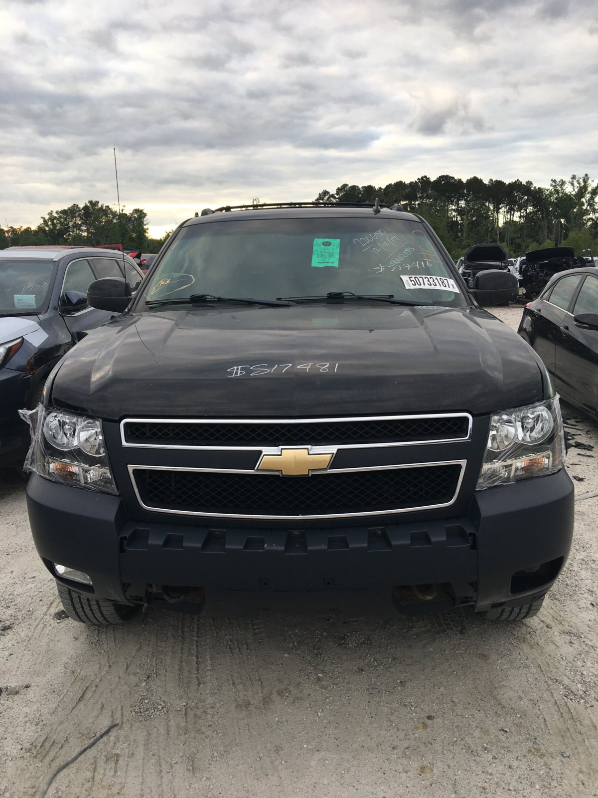

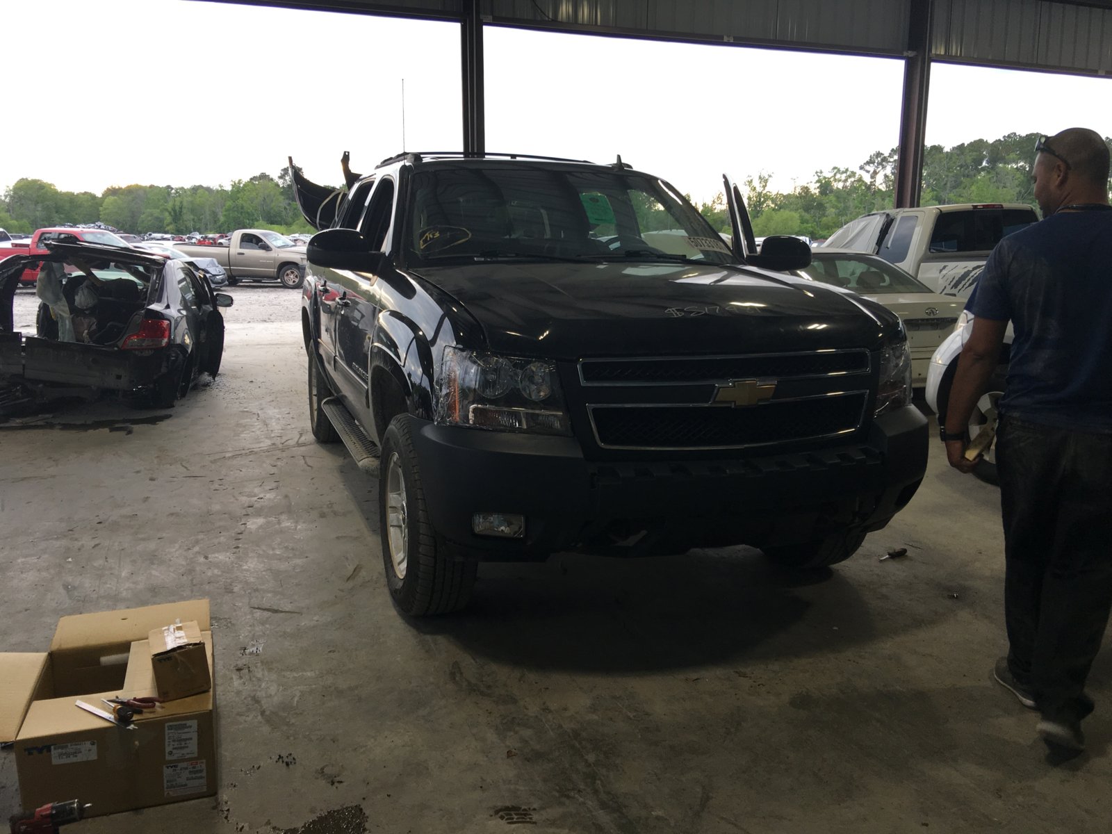

I think a previous owner leveled the truck with Rough Country products. A 2" level in the front at least. Check for spacers under the bottom of the front struts.

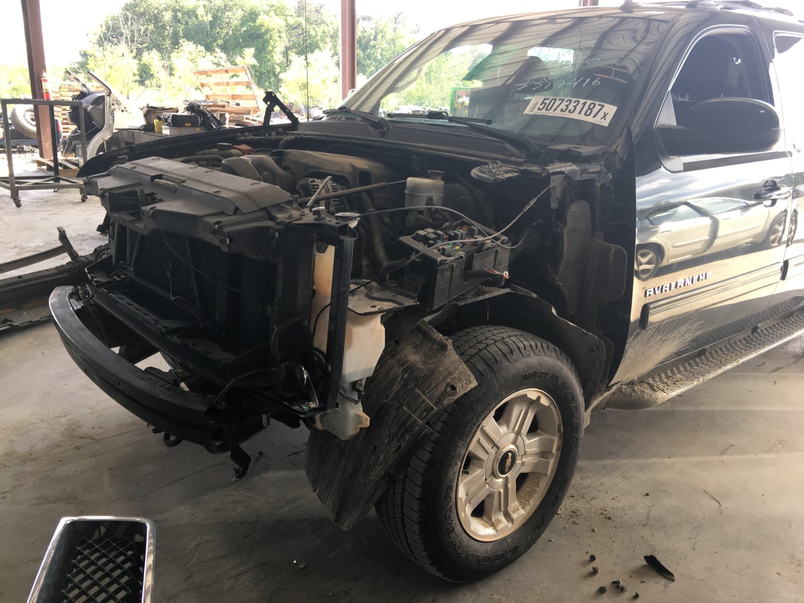

Was there leds in the headlight housings? Just curious--why new front seat belts? Did they stretch or get damaged from the accident?

No LEDs in the headlights. When you are in an accident, the seatbelts lock up. They lock in the place that they were in when the accident occured. You have to either replace them or have them rebuilt for them to function again.

I never knew that. That kind of sux about the belts. Looked like there was an led plugged into the harness that's on the back seat floor.

Oh yeah, that came out of the fog lights. I forgot about that one! If you look at the picture of the back window, the previous owner put a "Black Label Lighting" decal back there. Probably where they came from.
