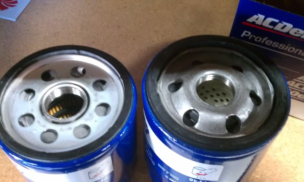

well i was wrong.. ill edit this, and post pix later.. the difference in the PF46 and PF46E is the base plate and the PF46E is a threaded INSERT.. Instead of being a solid part od the base plate, as on the PF46.

What difference would that make in regards to useage? When I returned the filter pepboys only had the 46e, so I did not purchase it.
Trixxterr
May 1, 2012
102
15
Jax, Fla
In the past. Too much pressure or overtightening could cause them to come apart, its a weak point. And to be honest. I dont sell many of them, I usually offer the other one instead.
