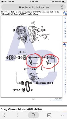

There's only two shift forks, one for high and one for low. If your engaged in one more and not the other, then yes, a shift forks could have failed, only way to know for certain is to drop that transfer case and crack it open. Also, you won't get a coffee for broken pads on a shift fork
