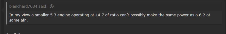

this statement,
this is the statement you stand behind and erased on accident ?
And you want to be taken seriously/ want people to think you have clue? And you don't think that this statement demonstrates a gross conceptual error?

this statement,
Okay, awesome. And BTW, that statement was refuted the first time I quoted it (you know, before you erased it on accident) see post #43 on page #5 (like you really should be taking notes, we're going over the same stuff like three or four times)
