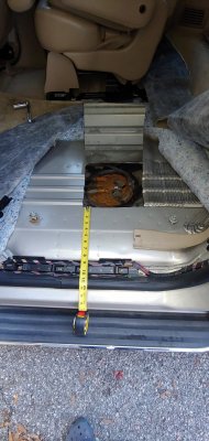

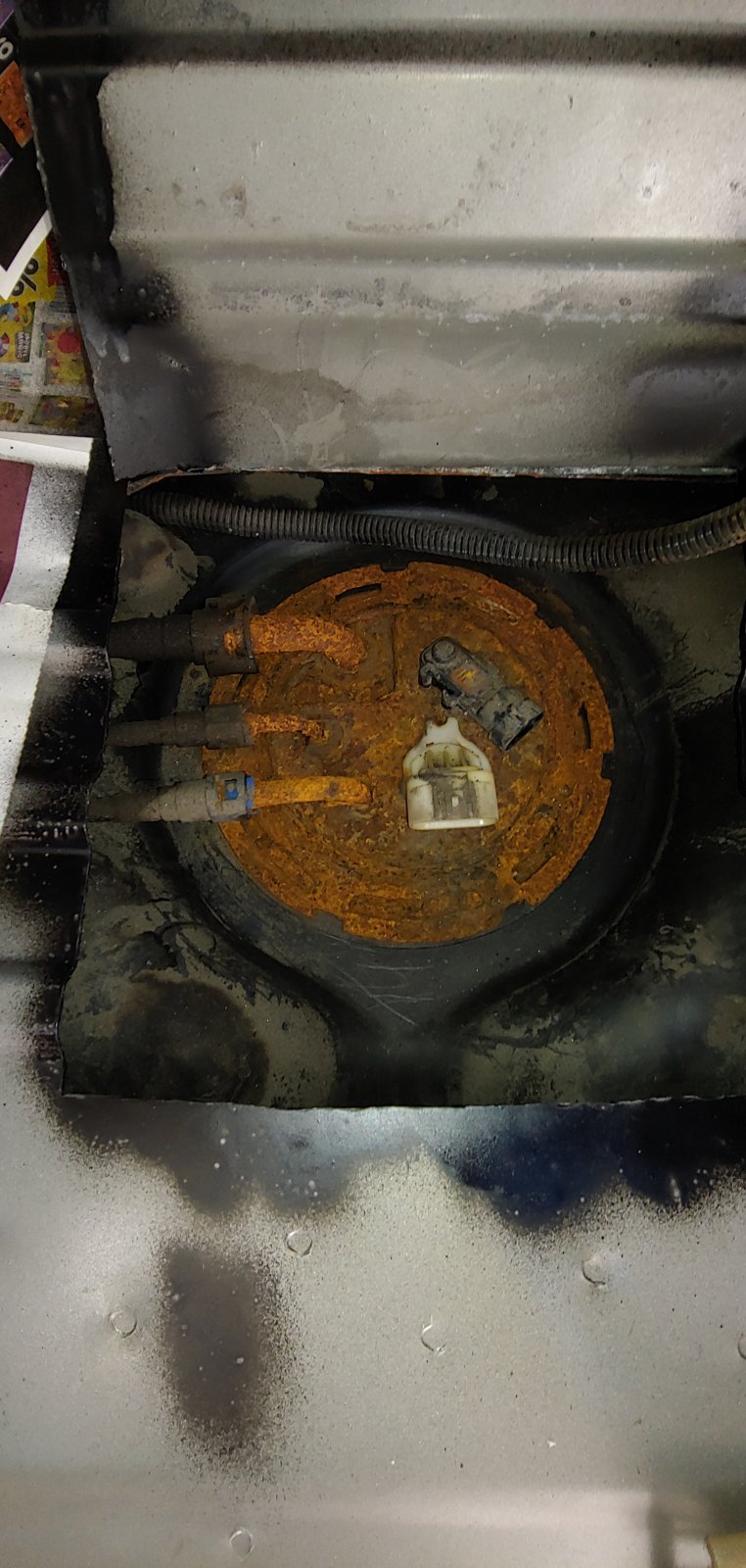

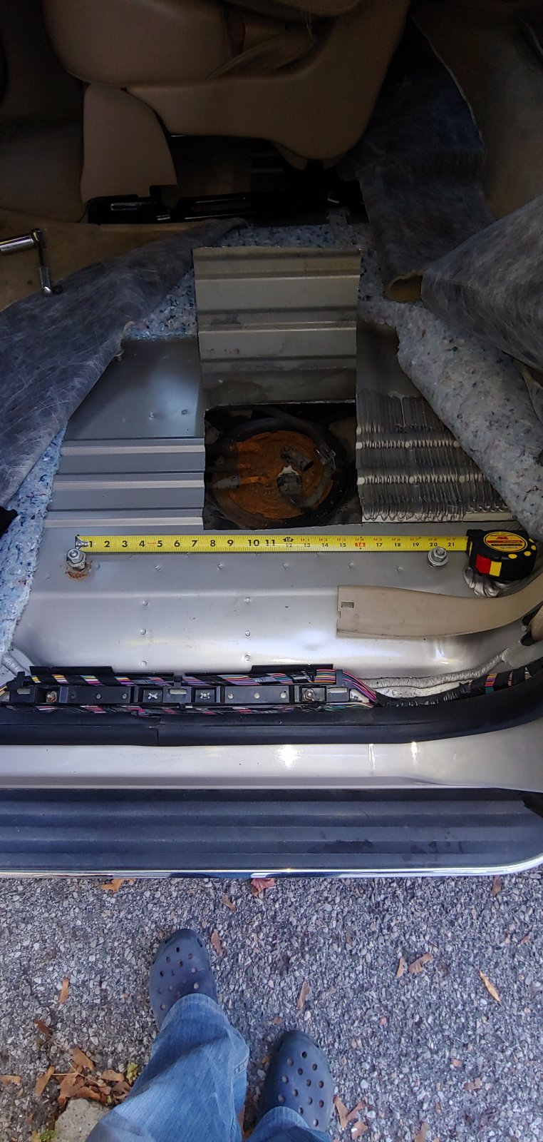

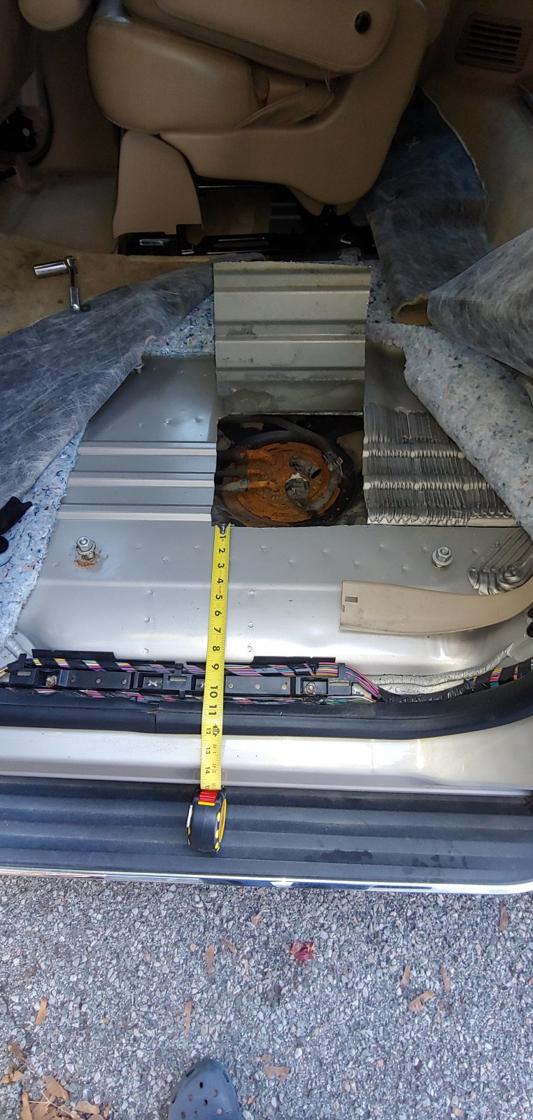

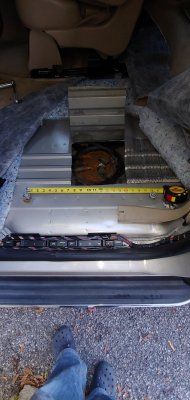

I did that modification 4 yrs ago and have had no problems, I dont recall the measurents but it was around a 8" square. I went to the junk yard and cut out a bigger square from another yukon and made a door out of it. Most people reuse the existing sheet metal, I didnt wanna take any changes of carbon monoxide sipping up thru the gaps. Best mod ever, I've replaced the fuel pump 2 times since.
Do you happen to have any photos showing the location of the access door that you cut?
