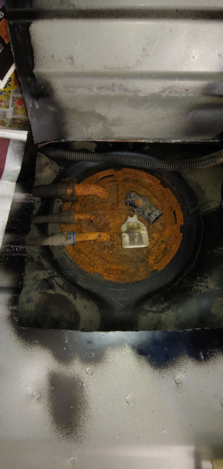

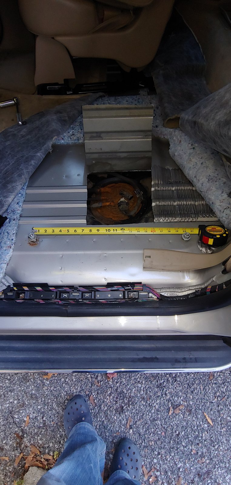

I love how fierce this debate gets whenever it pops up it never seizes to amaze me. If you do it right it is a great mod. And it saved my ass one winter when it was below freezing and mine took a shit and had to be replaced. I didn’t have to lay in the snow in my driveway fighting frozen, rusted fuel tank hardware. I had the mod researched and planned well ahead of time and even a section of floor cut out of a donor truck set aside to make an overlapping cover out of that would fit the floor perfectly, and could be sealed and bolted down. Been there, done it, and would do it again.

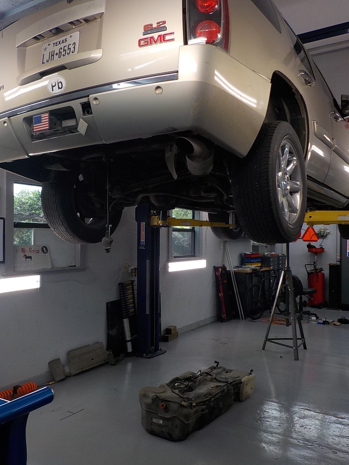

GOLDMISTXL, You really dont want to cut the hole in the wrong place and butcher your vehicle< soooooooooooooo you should drop the tank so you can see exactly where to cut the hole, I would use a dotco and make a "perfect factory appearance cut". hook all the lines back up, reinstall the tank,filler and vent tubes, lower the vehicle, open the passenger rear door and remove the necessary interior parts/carpet and than replace the fuel pump through the whole in the floor. LOL!!!! Hey just do it the normal way and dont let your brain talk you out of it, the best advice i have is to wear goggles underneath and a "du rag" to keep the dirt at bay. You will be done in 3 hrs.

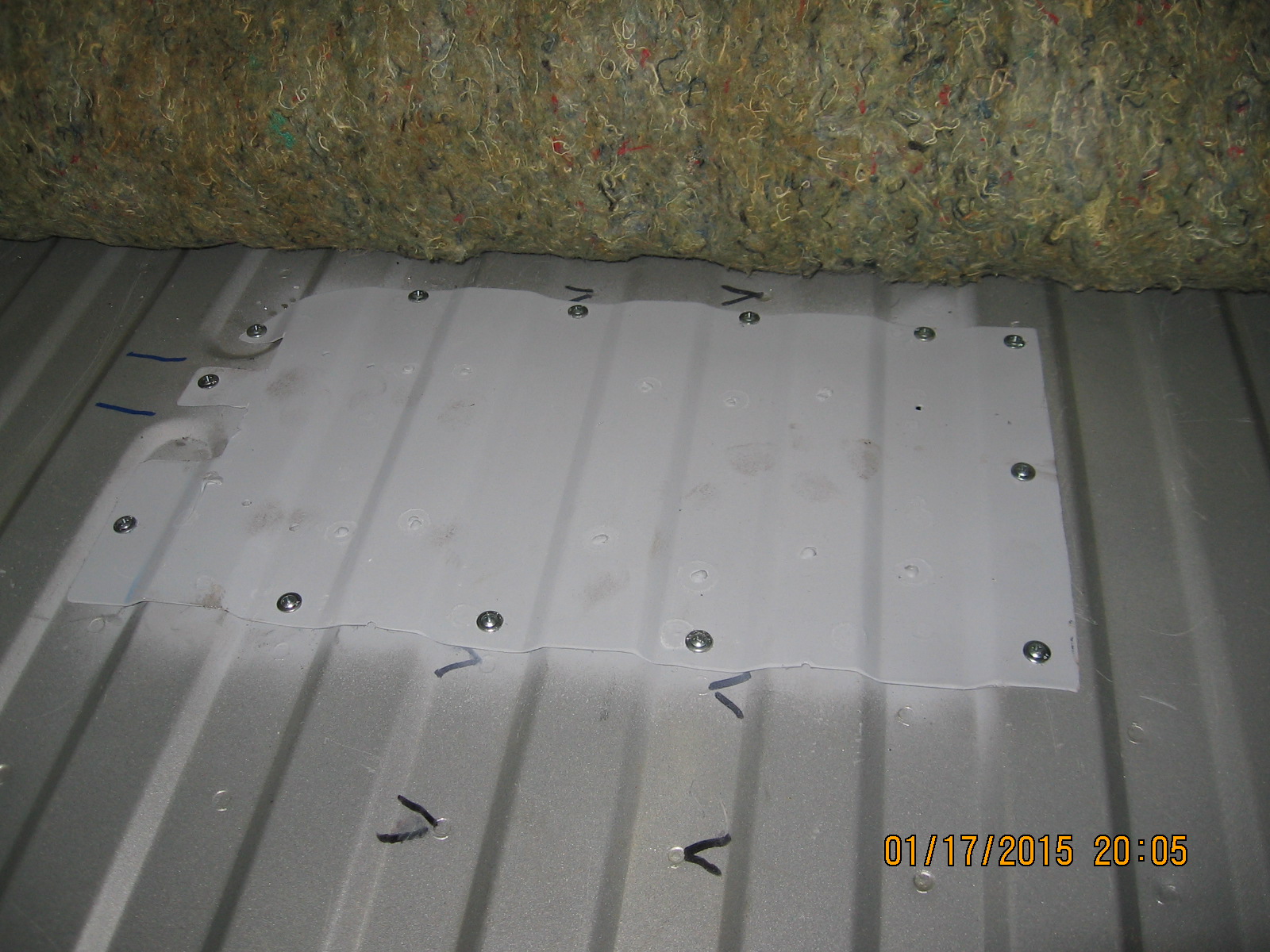

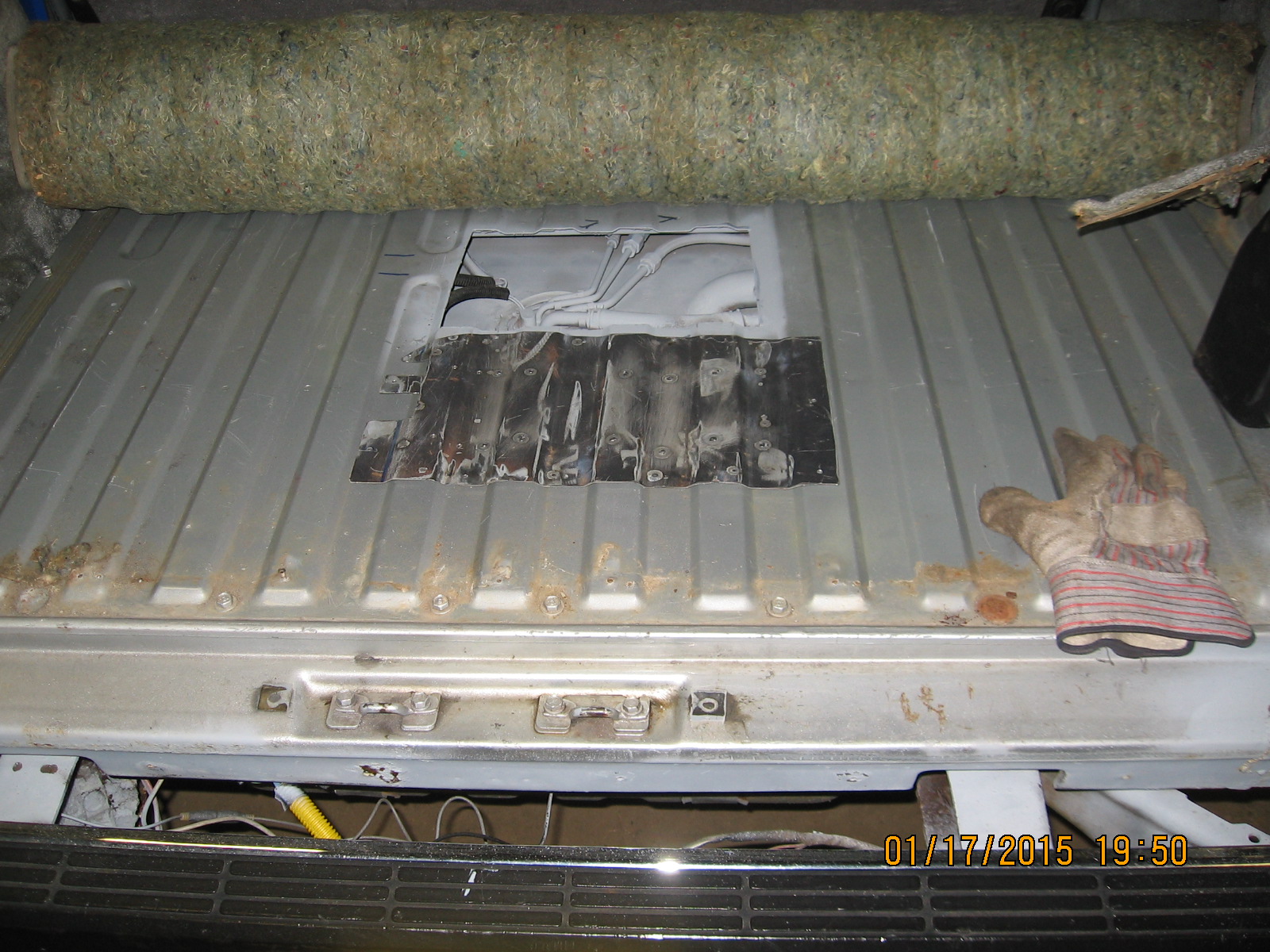

And also don't forget to make it big enough and shaped to allow access to the hose disconnects and wiring disconnects, lock ring removal, avoiding any under carriage cutting mishaps like hitting the tank or fuel lines, brake lines, under floor support brackets or wiring, etc... plus lifting it out without spilling fuel all over the floor. Beings as they seem to appear to hold quite a bit of fuel in their sump. Plus any type of rotation or clearance issues needed to massage it out of place. Keep a shop vac handy to vacuum any dirt and debris before cracking it open. A way to cover the mounting hole to help prevent fumes to escape from the tank during the transplant. Open all doors and hatches for extra venting and try to prevent build up of fumes. Plus once all that is done find a donor floor piece bigger than the hole you perfectly masterminded to fit over with enough flange to seal and bolt back down once the task is done. Or McGuyver it another way smartly. Plus don't forget the pics and video and detailed instructions while you are at it.
