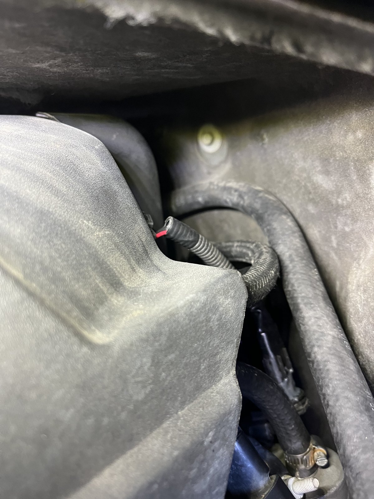

With the cover on, the harness comes out of the upper opening at the back. The factory hose clears the lower step of the opening:
Looking under the cover with it raised a little off the supports, but rear hooked into place, you can see the harness, sensor and braided hose all have plenty of clearance. That one bottom point is barely contacting the fitting on the factory hose. It might pivot off of it when the front is snapped down into place. Either way, it's not a problem. I'll probably trim it, anyway:
So, my little oversight in clipping the fuel lines on the sensor forced me to just roll with it and everything fell into place. It's not "factory", like I was aiming for, but it seems to be perfectly functional and safe.
