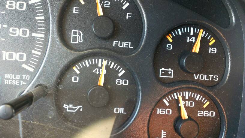

Worked fine till temperature started dropping
Haven't disconnected battery or nothing
Heater core??
This is where truck temperature remains now use to be closer to the 210 mark a3yne2ez.jpg

It could be that your Thermostat is stuck open. It is Spring regulated to keep the temps at 210. If it is stuck open it cant regulate the heat right. Have you ever replaced it before? Just my thoughts.

I don't have experience on this truck but with a stuck thermostat on other vehicles for me the temp wouldn't get above 160F, it usually sat pegged at the bottom of the gauge in winter conditions.
I have seen odd temps though when I had a car with a coolant leak before and it was low on coolant. That also could give the symptoms of cool air out of the heater as well. Not enough coolant in the system usually means the heater core doesn't have coolant passing through it.

I agree with Wake's help he's offering up, if you coolant level is full then your thermostat is more than likely stuck open!! I had that happen to a pretty new thermostat on my denali some years ago, I had changed the coolant and replaced the thermostat when I did the water pump. 6 months later driving home at night in the winter from a boat show all of a sudden my heat turned to cold air. Looked down at the gauge and it was dropping to almost pegged out cold but then stopped right before full cold and stayed there all the way home!! NO HEAT AT ALL!! lol
Changed out the thermostat the next day and all was good again even to this day, I did boil the old one and low and behold it would get to full open and just stay there!!
With your temperature gauge where it's at and you have very little to no heat, I'd say you need a new thermostat, and while you are at it I'd flush out the whole system out real good with water!!
