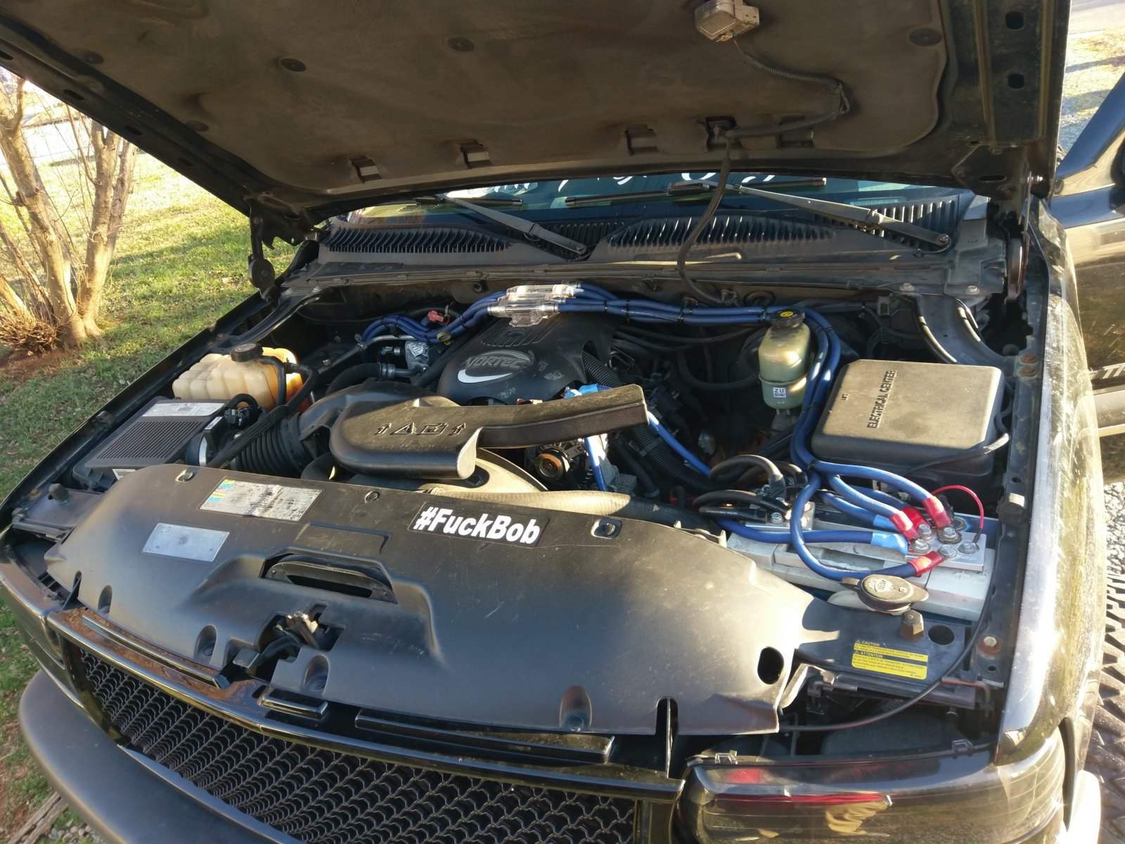

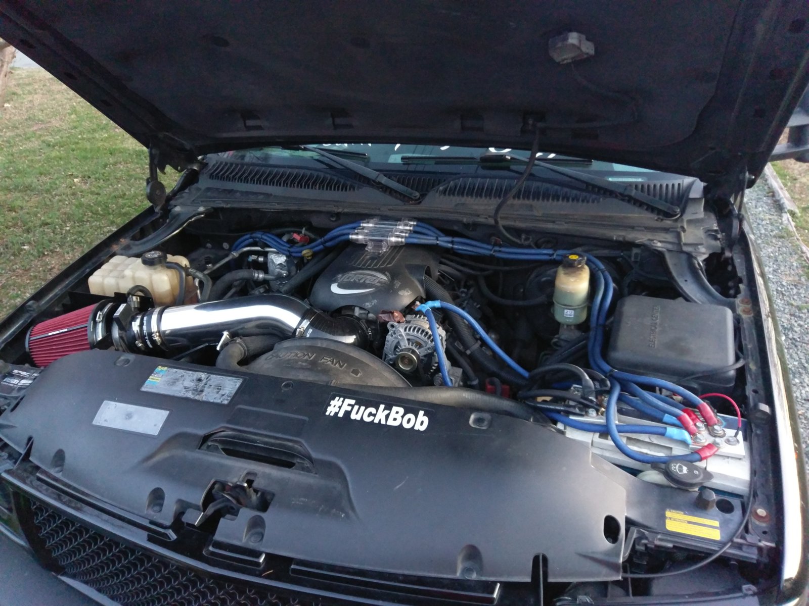

well it's clear as day in your photo's that there is 0 gauge wire connected directly to the alternator, I think you are missing the point of "disconnect any wires to alternator" and then take it for a run. just offering a suggestion to resolve your problem.
I didn't mean to come off like a dick, my bad, I greatly appreciate the fact that you are offering a suggestion and trying to help me out here, but I was just explaining why that wouldn't be possible to try...
It's a self exciting alternator, meaning it doesn't rely on a signal to tell it when to work or when to not work, so if it's spinning, it's automatically charging. So a positive wire HAS to be attached to it so the power it's producing can go somewhere or else it will burn itself up almost instantly...
