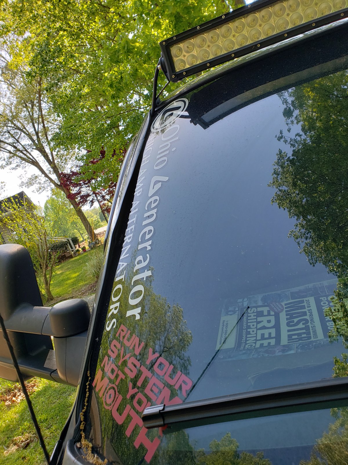

Pull the light bar just to eliminate it. Replace that alt with a stocker from a junkyard so the belt will still work to eliminate the alt. Or keep guessing about those two. I'm betting on the alt.
I have already un hooked the lightbar and it didn't go away so that's not it. And I'm currently trying to get my hands on a stock alt to try that out here soon.
Just generally speaking, alts are so sensitive that if if anything is wrong with them, charging voltage is usually the first thing to go and with how high mine is sitting while going down the road it just makes me skeptical that that's the issue, but I won't rule it out until I have tried this.
