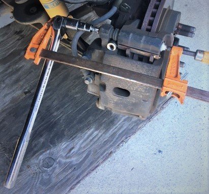

There are a few videos out there showing how to clamp the breaker bar against the caliper to reduce chances of stripping the T55. I'm going to try this in about 1 hour. I'll see how it feels and then resort to impact clamped against the caliper with low air pressure.

as already mentioned I would avoid a impact period some of those bolts are aluminum (on my 2012 they are) and a impact will round it out before you can even blink an eye, use a BIG breaker bar and turn the wheel/hub out so you can get in there

I finished installing the other bearing along with new guide pins/bushings and the 3 bolts that hold the bearing in. Here is my setup for getting the T55 to move and not stripping it. Note socket to stop the caliper from sliding when under pressure from the clamp.
