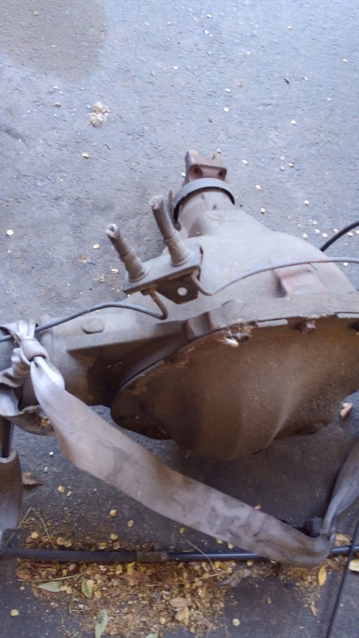

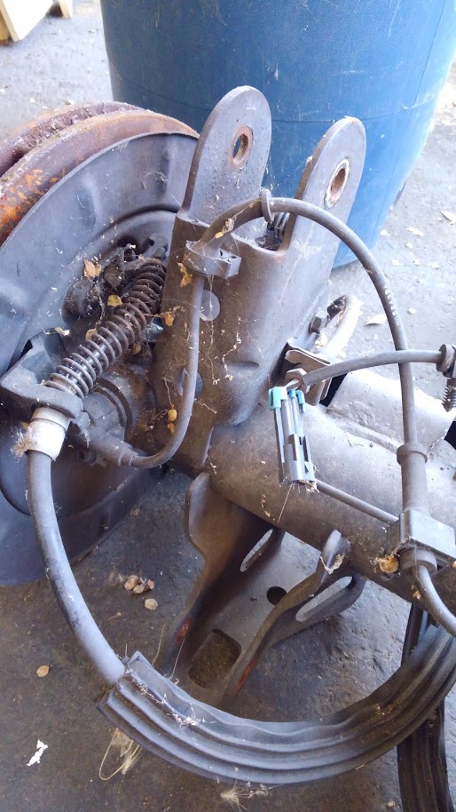

Go to LKQOnline and look for 14-Bolt Saginaw 9.5" axles (RPO AXN) in RWD Escalades and Denalis (2007-2014), they all have 3.42 gears and G80. Just bought one for $289 plus tax but every area is different. LKQ even warrants it. So you have to tell them yours has a 9.5 with 3.42 gears.
We'll eventually install 3.73s in ours.
Is a rear driveshaft swap required with that upgrade? Usually a bigger diff means a shorter shaft.

The 9.5 is a great upgrade, but my opinion is the 8.5/8.6 is plenty strong for stock to mild power levels. The govloc (g80) is the weak link. Get a good quality posi unit... trutrac, auburn spring type etc, and you'll be fine. I know there is a significant weight difference, but i have a 8.5 in my nova making 400ish at the crank and a 2400 stall converter pushing through a all stock 8.5 with a mini spool and havent hurt it in 10 years track or 8000 street miles.
Nope. Same part number.
Let's not forget that your Nova and my old Buicks weighed less than 4000 pounds in racing trim. We didn't need to beef up our axles until we were knocking on the doors of the 9s in the quarter mile. If memory serves, that was Moser axles with c-clip eliminators but I never even did that.
