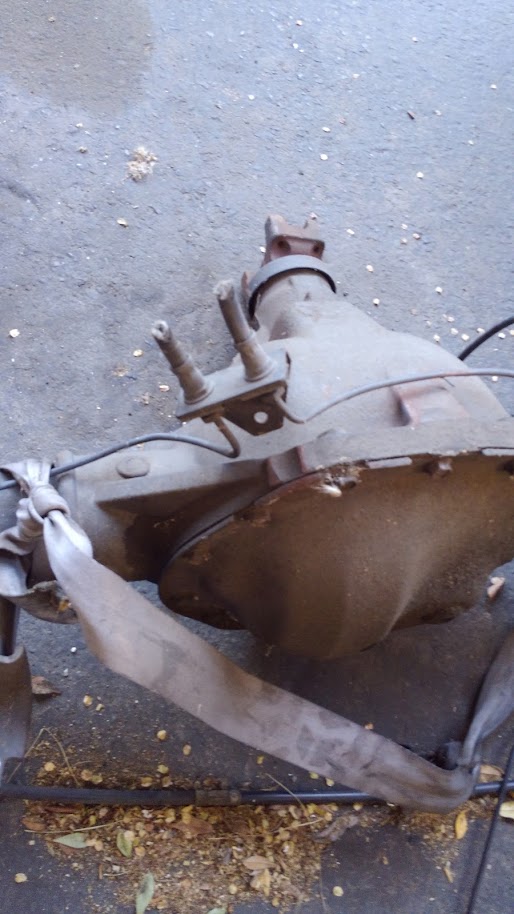

Sorry I should have been more specific...is there a 14 bolt, 9.5" axle that will bolt right up to the 2000 - 2006 Tahoe? I that's whats on the Escalades or 2500's??

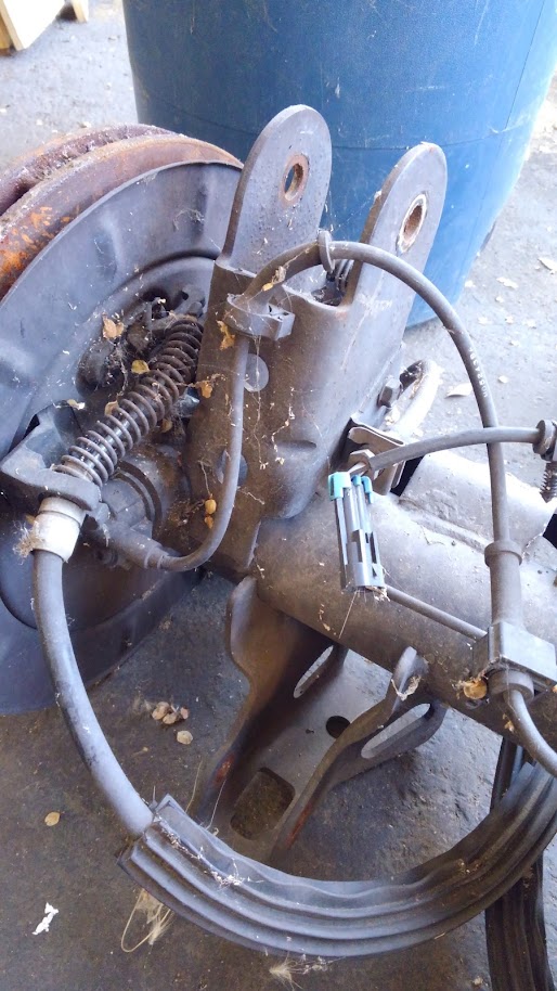

I will find out the answer to your question in the next few months. I have the axle, but it's not installed yet. There are 2 minor differences I've noticed already but haven't seen what it'll take to overcome them. The rear drop brake line is single on my Tahoe 10b and the drop brake line on the Escalade axle is dual lines. Additionally, the wheel speed sensors appear to be in a different location on the axle of the 14b vs the 10b. I'm hoping the wheel speed sensors will just plug in. The brake line I haven't sorted out yet. From looking at it, it appears everything else will be bolt it up and go. Time will tell.
