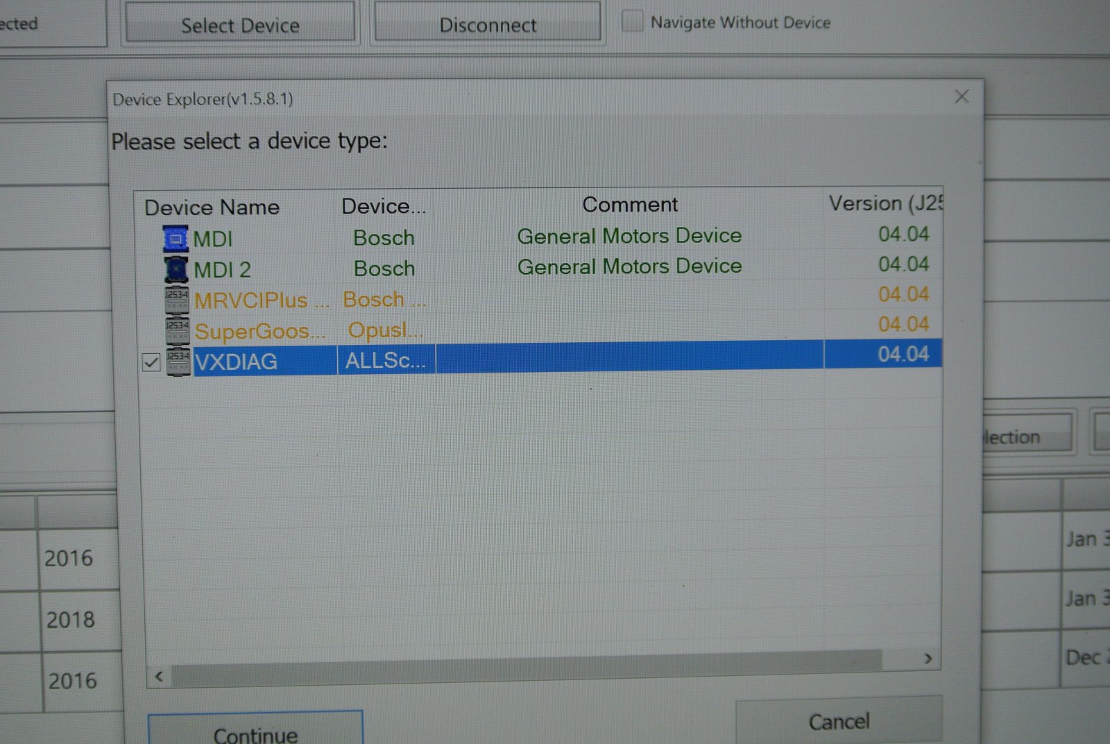

I Uninstalled everything and started over. Still getting this message when i open tech2win. I can see the vcx nano connected on vx manager. What am i missing?20221128_141511.jpg
And now this doing more digging within my pc system settings
