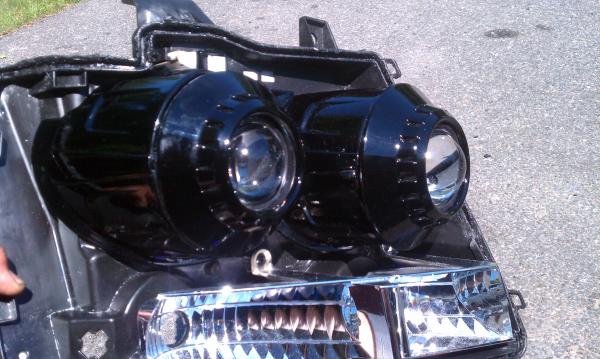

So this is the package I'm about to purchase for the oem housings (no halos):
Main projector: OEM FX35 bi-xenon w/ FX-R clear lens
Secondary inner projector: Morimoto Mini H1 bi-xenon
Ballasts: Morimoto 3Five 35w for both
Shrouds: E46-R Extended for main + E46-R regular for inner
Bulbs: Morimoto 3Five 5000K D2S for main and Morimoto 3Five 5000K H1 for inner
Wiring: 2x H11 relay harnesses + 9005 to dual solenoid splitters to make quad high beams work
Thoughts before I pull the trigger?
