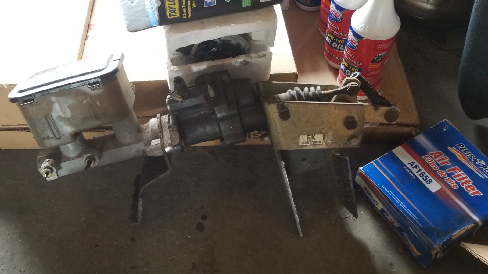

Btw, any benefits to converting over to a hydroboost brake system (the type that runs off of the power steering pump) instead of running off vacuum?

nah its easy, all factory parts.
the hydroboost unit (sounds like you have)
the hydraulic lines - it loops it in with the power steering rack (you prob also have theyre cheap if not)
the pedal out of a hydroboost truck you may have to get from a junkyard out of a 2500/3500 truck or van.
i had to change the master cylinder but i think thats because my truck was older (92 c1500) might not need to be swapped for a 99, and i needed adapter fittings to go from the master to my stock lines, you may not need

Think the pedal from the RV will work or no?

i mean take a look it may work, hydro/nonhydro pedals are pretty close the the same just the pivot point is a little different or shorter throw or something i dont remember off the top of my head. may be able to make it work
