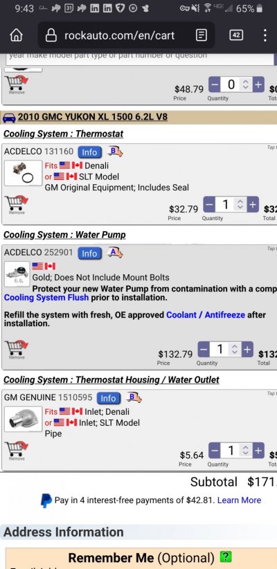

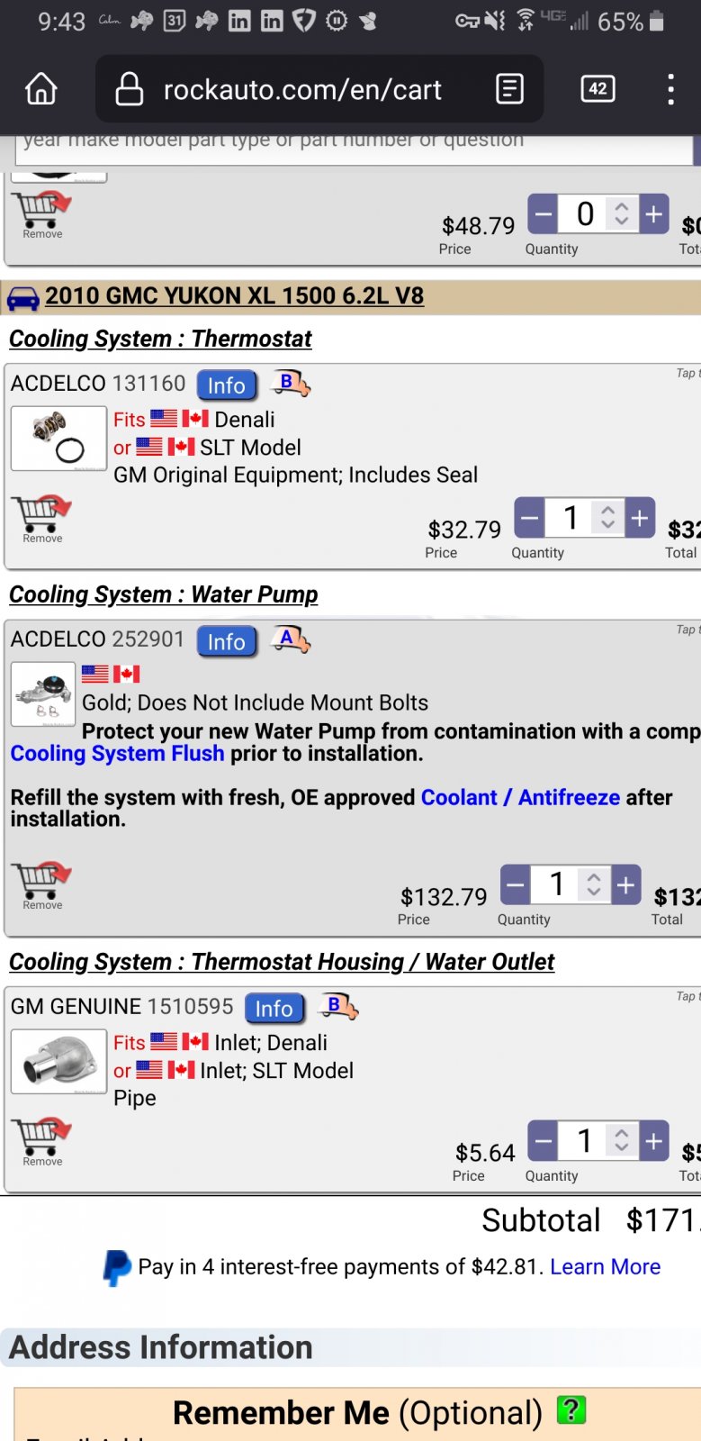

I'm going to take a little different stance on the water pump. You already have the coolant out of the system and everything else out of the way, so why not just change it and eliminate it from the list of things that will get you stuck somewhere? It's an easy job and you can buy one with the thermostat housing and thermostat already installed. It might add 15 minutes to the job you're already doing.
