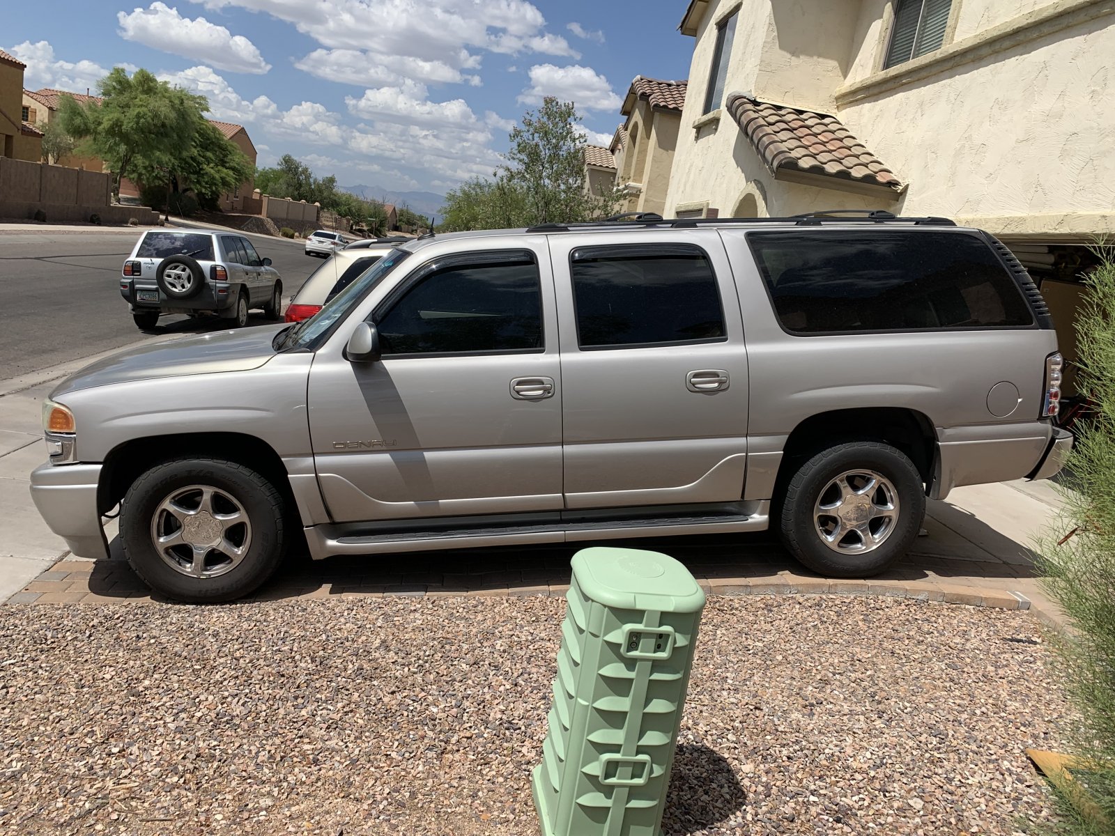

When I De-badged my truck, I used braided fishing line, some Goo-Gone, and an eraser wheel on a drill. And I used them in that order. Then I polished that area with some polishing compound and some finishing polish, and the outline on the paint completely disappeared.
And the braided fishing line worked GREAT because it has some texture to it, so it's better for sawing back and forth on the foam mounting tape.
Here is a before and after picture of mine De-badged.
