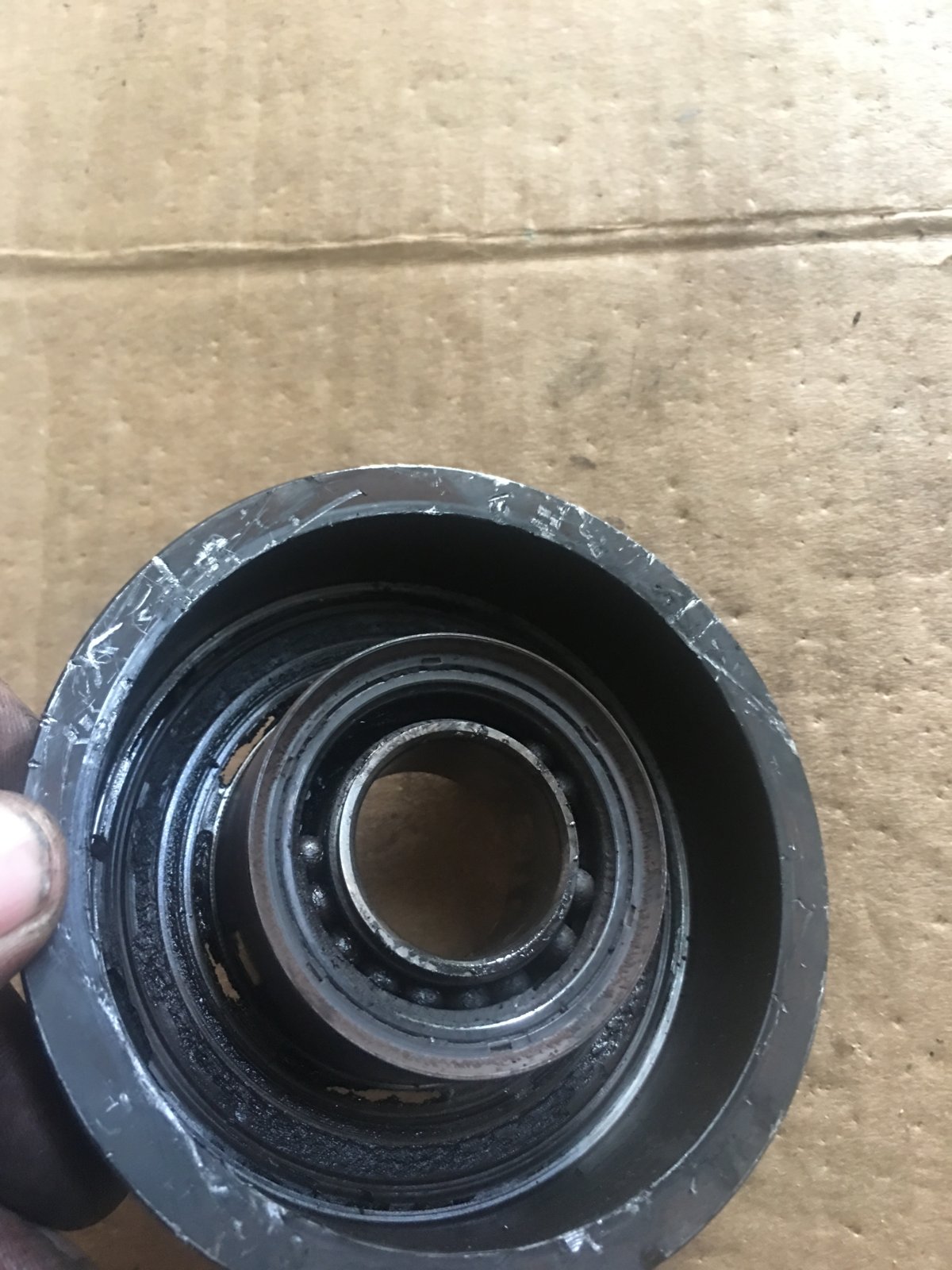

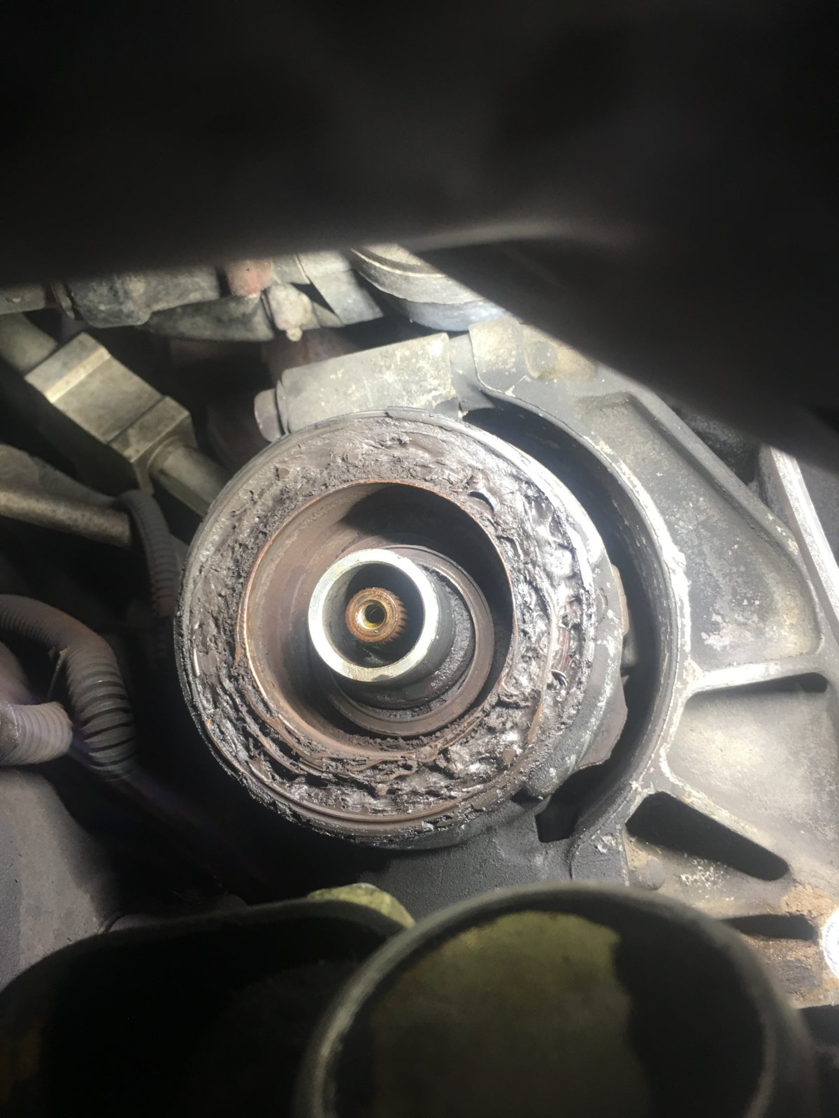

The ac belt tensioner? Mine actually seized once.
The pulley bearing bit the dust which burn up my clutch and coil. Not even a squeal/squeak/grind... pulled everything from the compressor and here ya have it.
1DC4FABF-EA61-4B3F-BD24-06C36865EAC5.jpeg 95F97BA0-4C39-40D9-B031-62A66A93B1E2.jpeg 0F4E5EB3-3905-4251-BBB6-A17363120E34.jpeg 74E83DC4-6E55-4AF0-A423-3907E67C5A23.jpeg
The coil still energized and engages the clutch but due to the extent of the damage just gonna replace it all. Parts will be here tomorrow. Rebuild kit -100 bucks.
