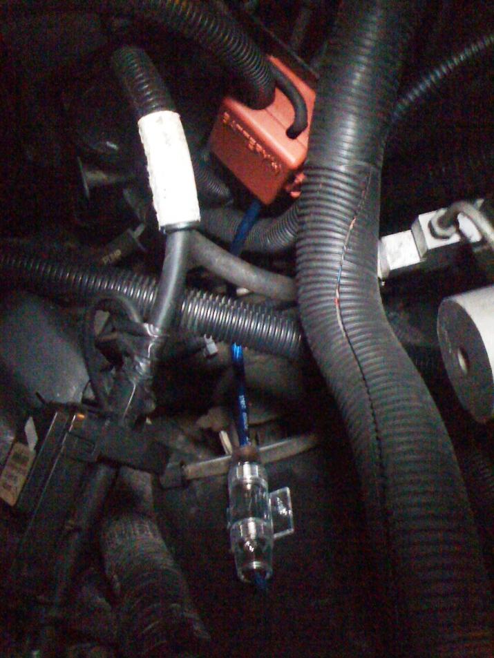

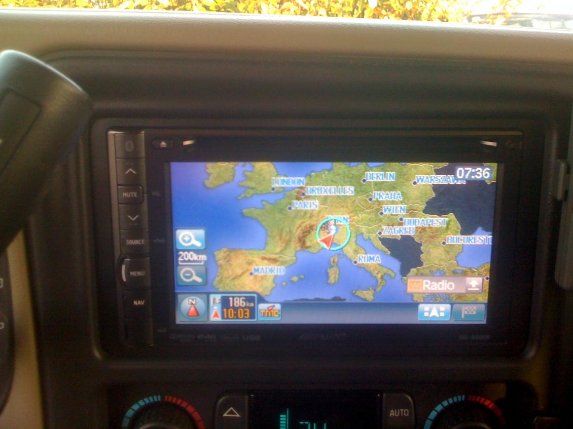

Installed a Rockford Fosgate 250W Amp to my Kicker Solobaric 10" Subwoofer in a Bandpass Enclosure. Also hooked the reverse wire sensor to my Alpine Nav Head unit to complete my Rear View Camera installation. Thanks to the posts which said to hit the BCM, Blue Plug, Grey Wire, position A8. It worked like a charm.
Also, went through the Firewall at the small plug just to the left of the main wire plug. It was a hell of a lot easier to pass through there with my 4 gauge wire.

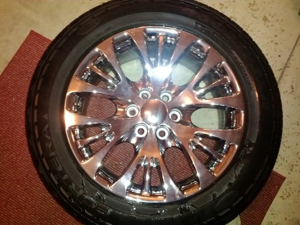

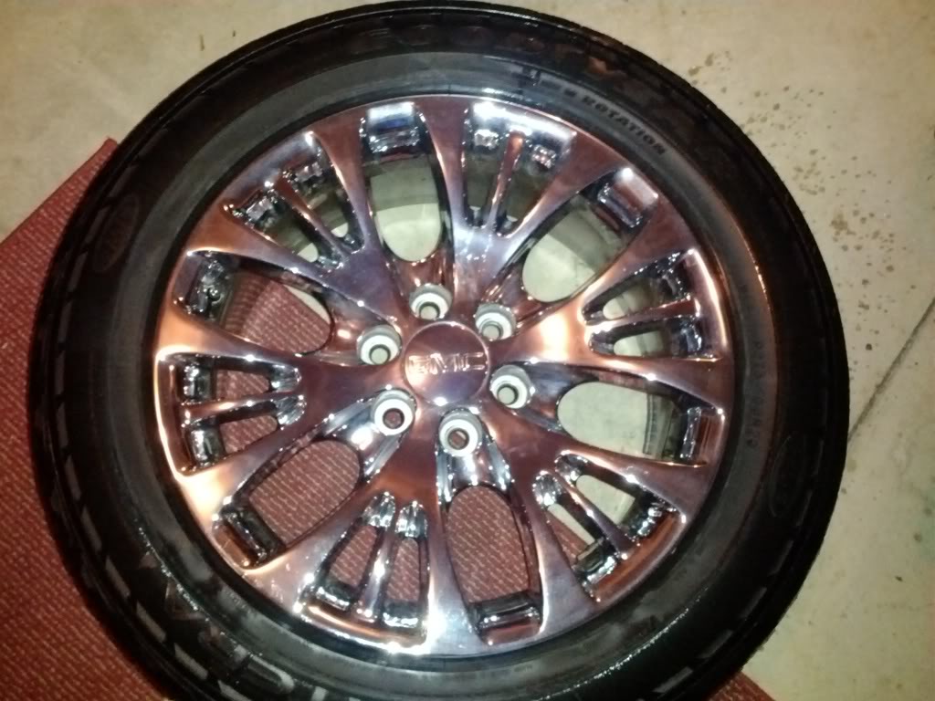

finally cleaned my summer wheels that have been sitting in the garage for a week and brought them down into the basement. So I finally swapped out my blank center caps with some GMC ones.
Before:
After:

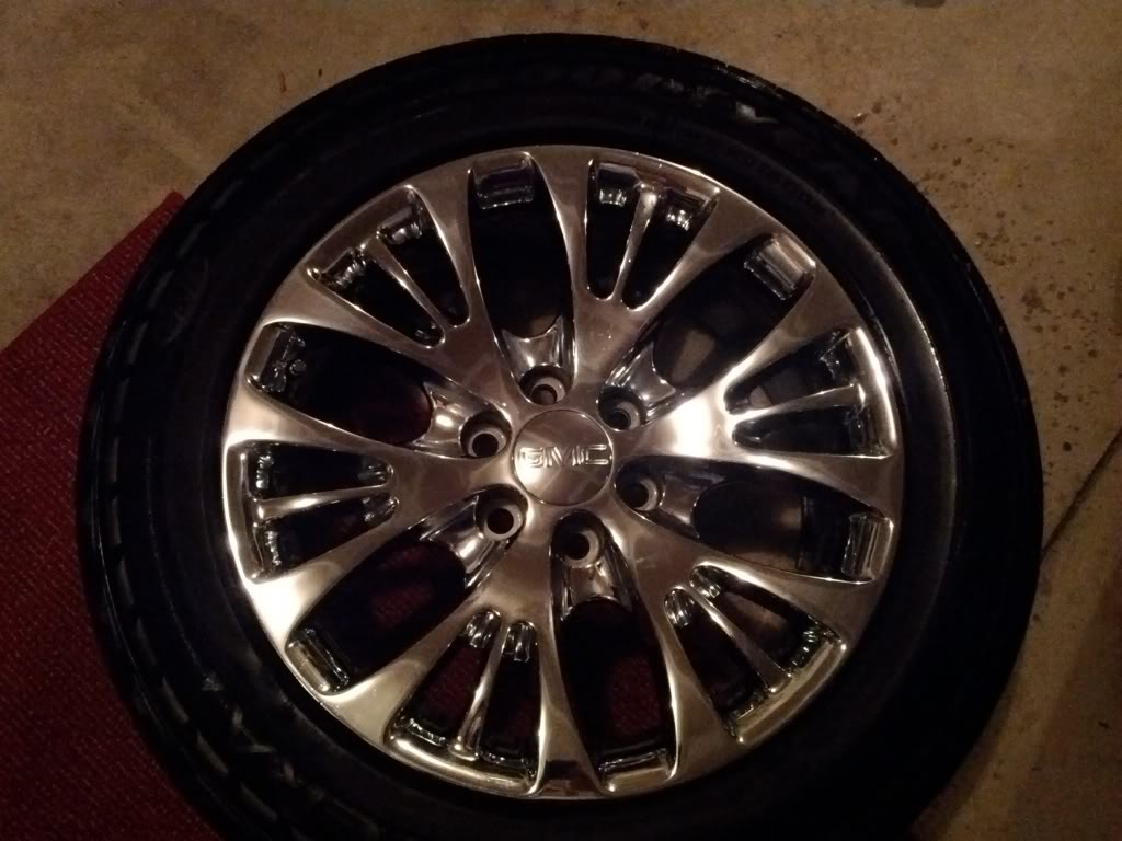

Before:
After:
VERY NICE! Looks so much better with the GMC Center Caps for sure.
