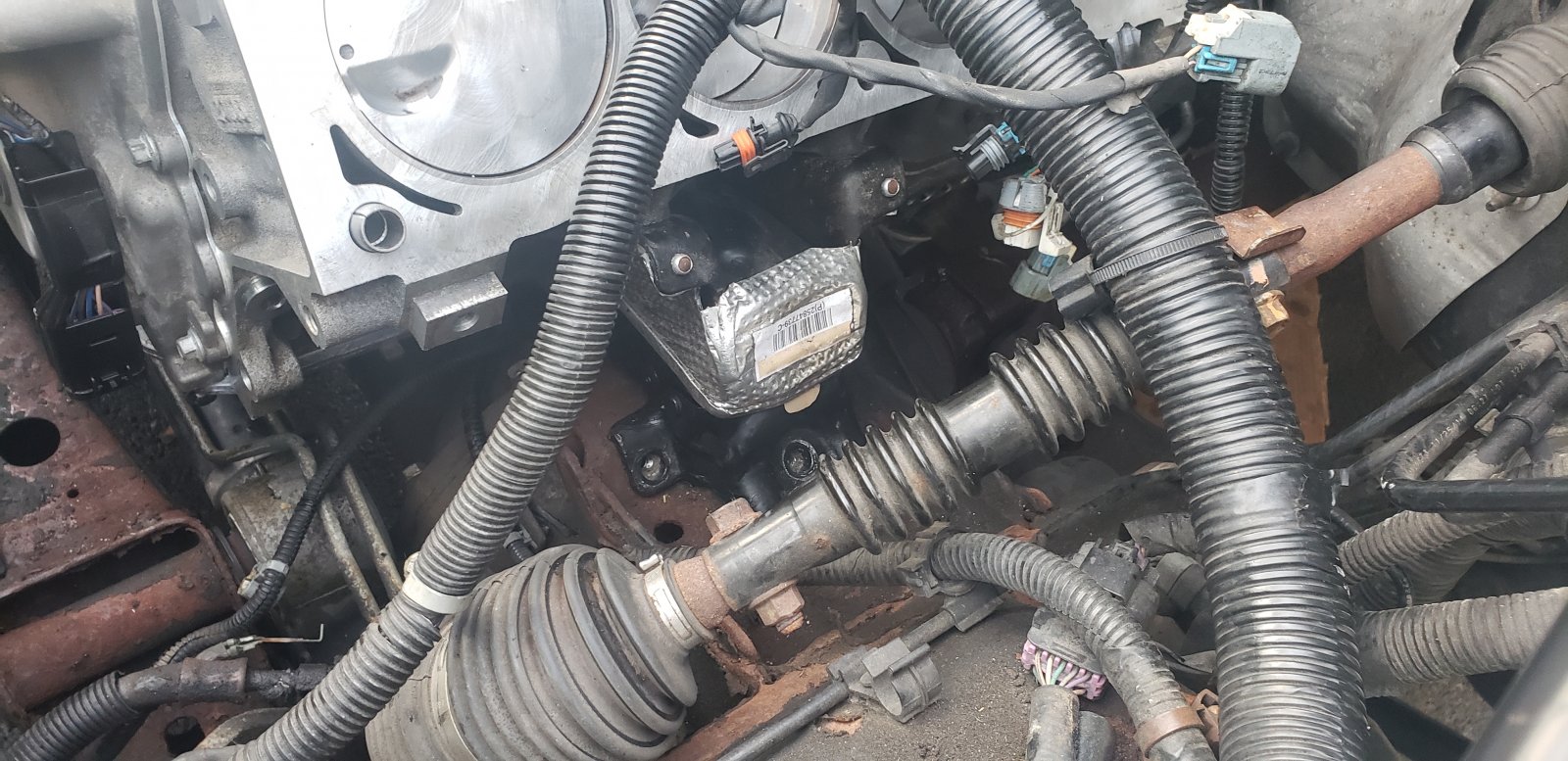

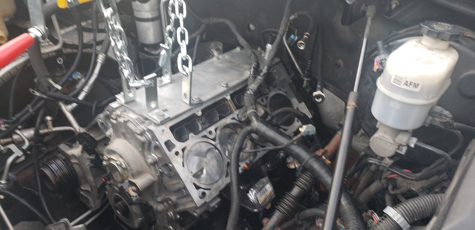

One side done...
Some of the carbon is very stubborn in the valve reliefs, so I just left it as is. It'll build back up again anyway. Wish the E85 station near my house didn't shut down.
