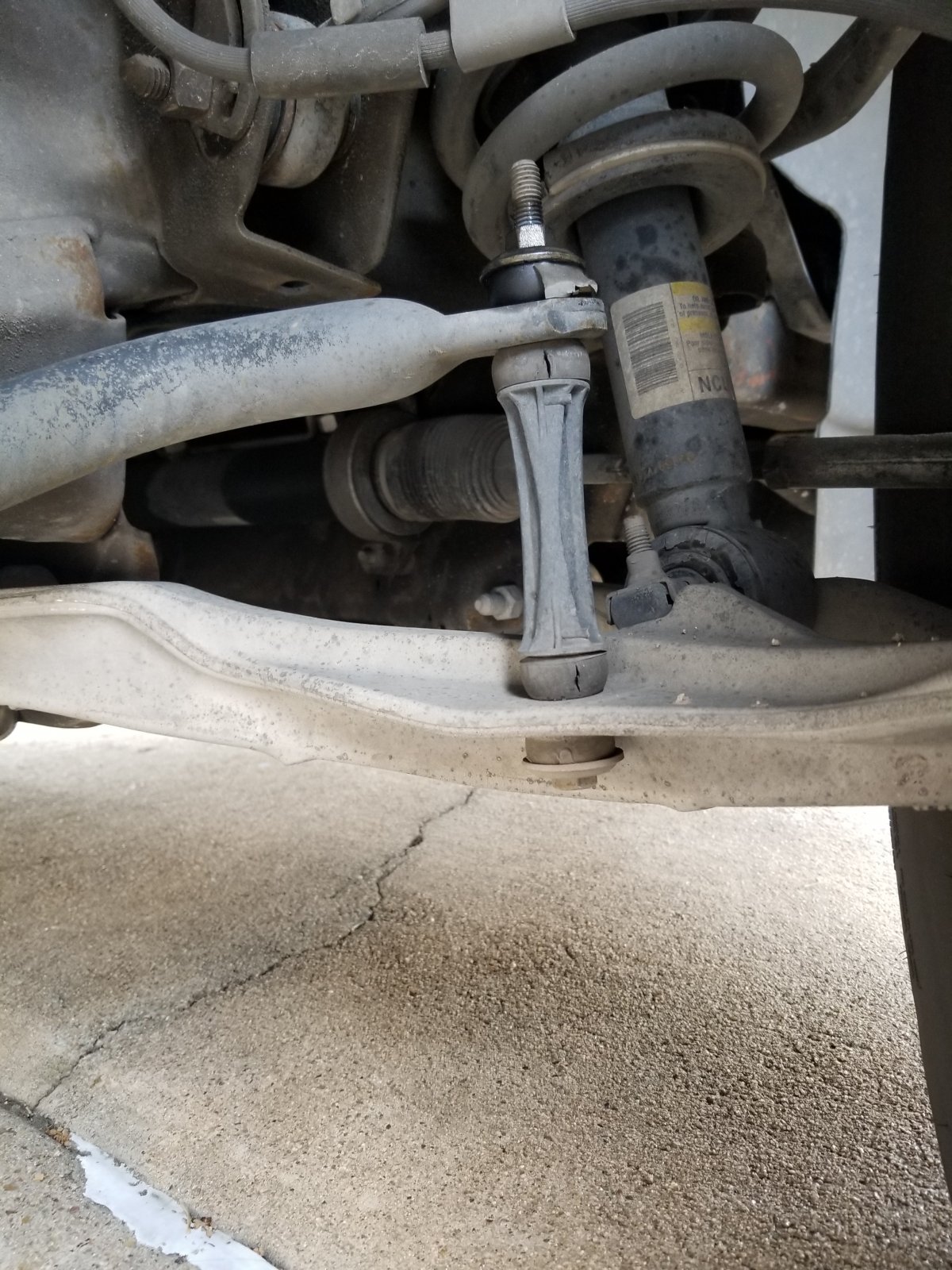

I've noticed that where the lower strut mounts to the lower control arm is different on all these newer ones.
That area is recessed on the new arms while not recessed on my OE arms.
Guessing that the newer parts is an updated design and hope it doesn't mess with the ride height.
