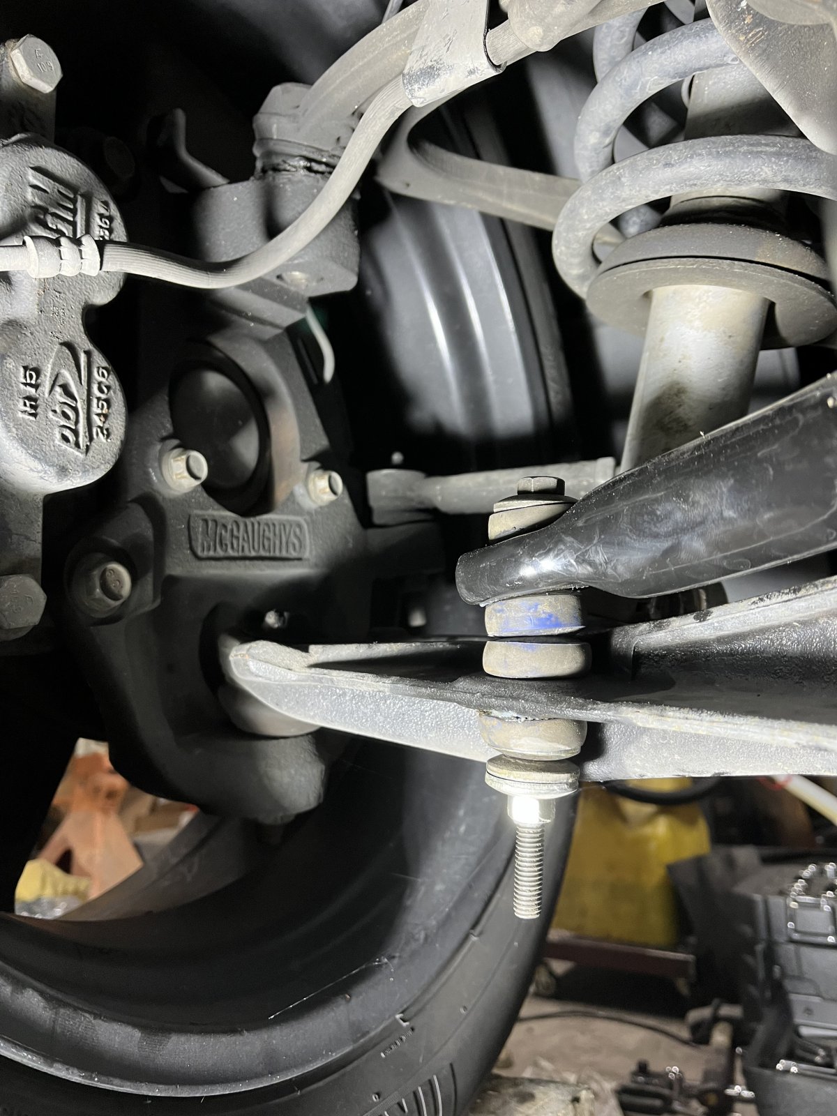

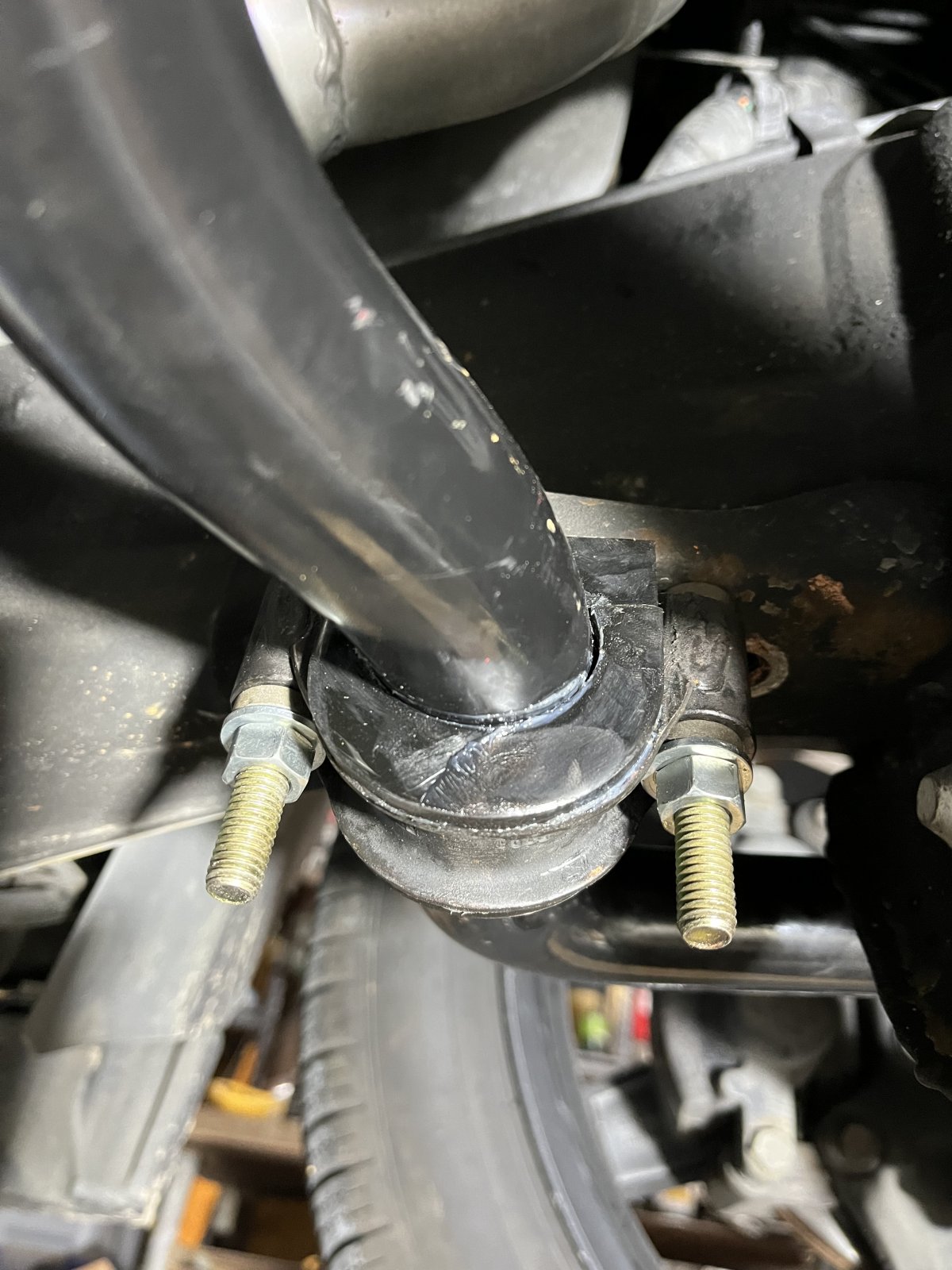

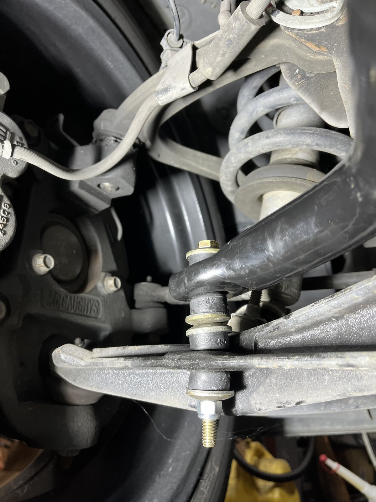

Yup... More sway bar stuff. Did something about them stupidly long bolts and made yet another set of end links.
Frame mount before, with spacers everywhere to make up for the excessive bolt length:
Flipped the bolts around and made spacers to match the ones in the rear mounts. Also used Nyloc nuts this time:
End link before with extra washers everywhere due to the bolt length and limited threads on the shank:
Shorter, Grade 8 bolt with new bushings. Used the dished washers between the center bushings this time. The holes in the sway bar and control arm are huge so the bushings are almost too small of diameter. That's why they're sitting a little crooked. Oh well, they're not squashed and blown out sideways like the old ones. Not yet, anyway:

Beauatiful!!! I am lost on the upper control arm ball joints. How are they secured to the knuckle?

Mind yo bizness. That's an experimental hardware design I've been developing for a few years. It's to cater to those situations with minimal space allowance and lack of available hand tools. To rigorously test and prove the idea, I applied it to a very critical attachment point- my upper ball joints.
All I'll divulge at this point is that the hardware uses the security of a Bluetooth 5 connection following the L2CAP protocol.

I don't remember how I did it, but I broke the tip off the ball joint stud. It sheared at half the drilled part that the cotter pin goes through. It was a new upper control arm/ball joint/bushing assembly being installed while lowering. I wasn't gonna stop the whole project for that. I staked the stud and marked the nut so I'd be able to tell if it turned. It's been over three years and about 30K miles so far. It's fine.
