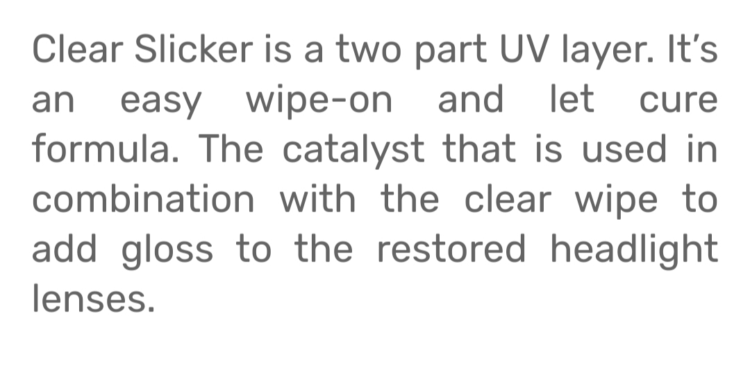

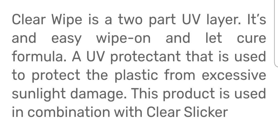

Is there a special clear for headlights?
Not really sure. Maybe you can inquire at a place that sells body shop supplies? When I used to do them for my business I'd use a 2 part clear that I'd apply with a limitless towel. It had a uv blocker in it. Unfortunately I used to buy it from the trade school I went to, and they rebottled with their own name on it.
tungsten
tungsten
Sep 22, 2022
338
613
Ill do some research thx,spraying my 1k clear on maybe an option.
