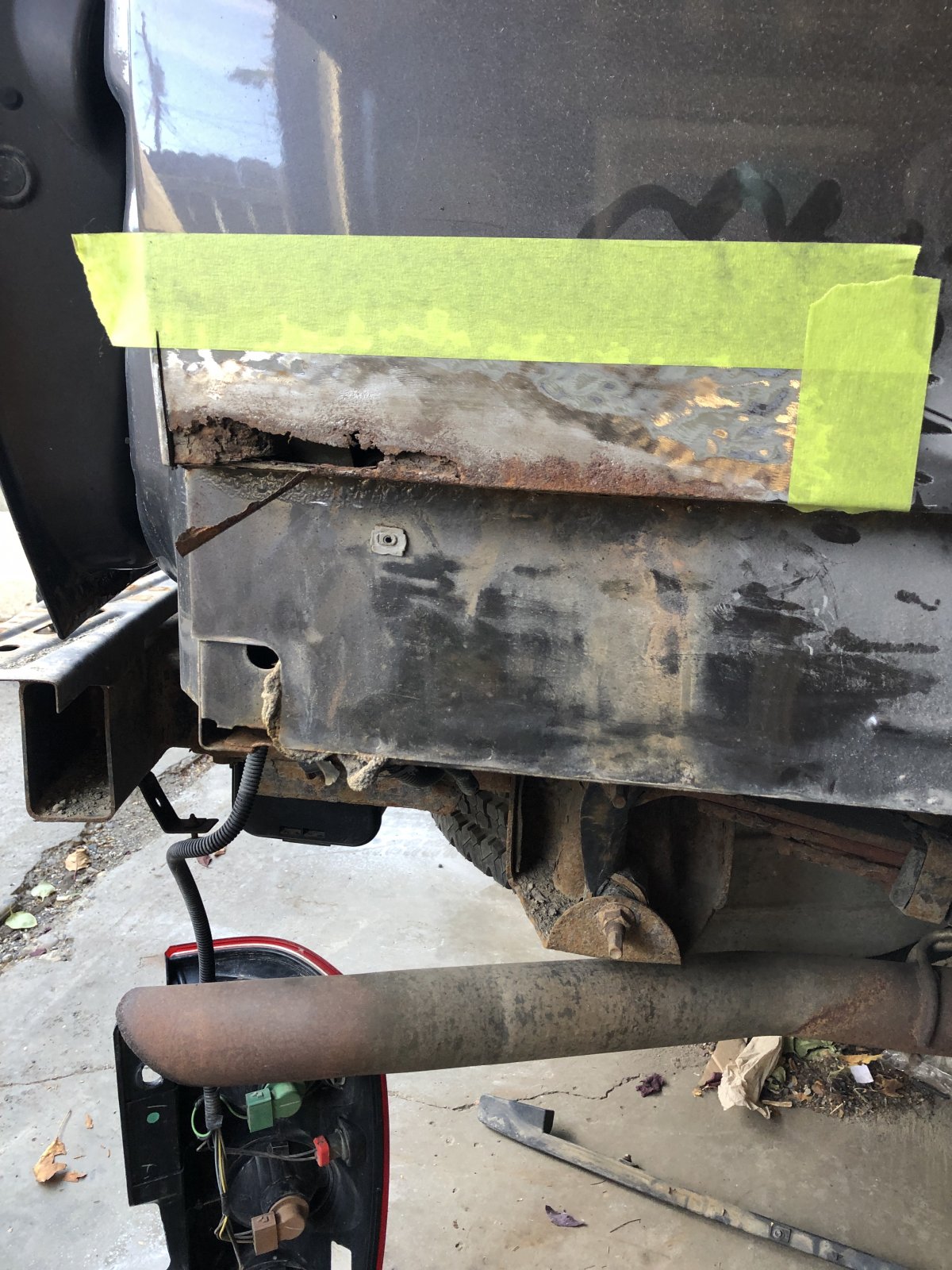

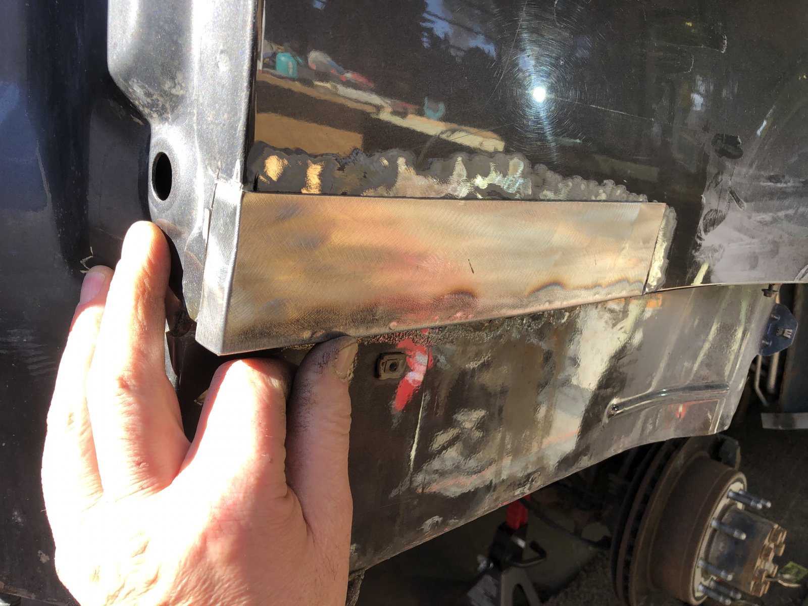

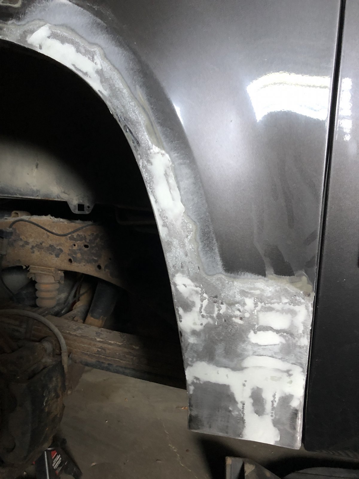

Working on passenger fender. Pretty rusty underneath and about 3/4” up. Started with the vertical piece.
Got that sitting Flat. Made a template from the other side for the horizontal piece that goes underneath
welding it up on the bench and I ran out of gas for the welder. Crap To the store tomorrow I go.

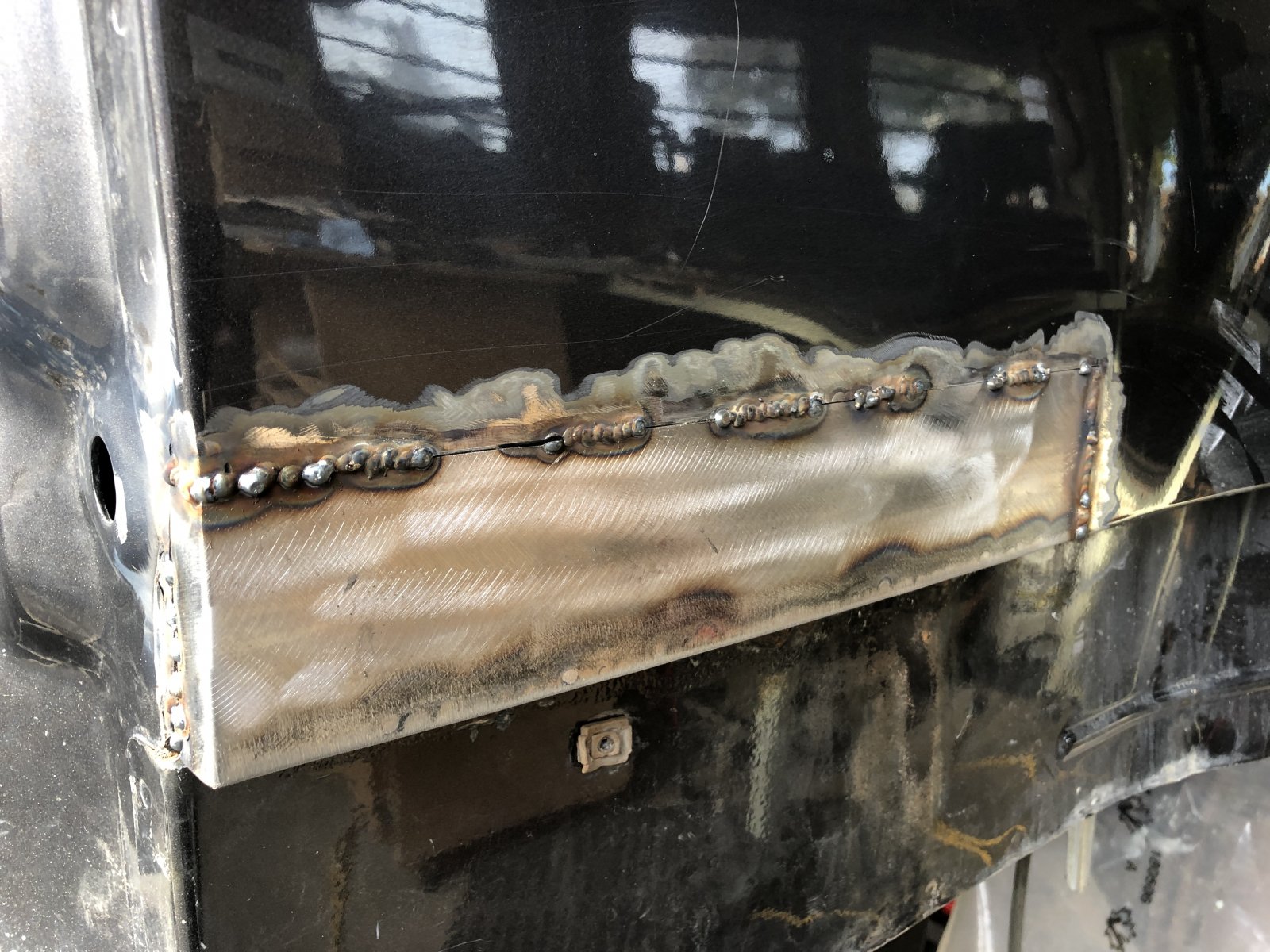

Well about a thousand tack welds later. I’m low right where the welds are so worked good don’t have to grind welds any more. Haven’t done a light test yet. I’m sure I missed a few spots.

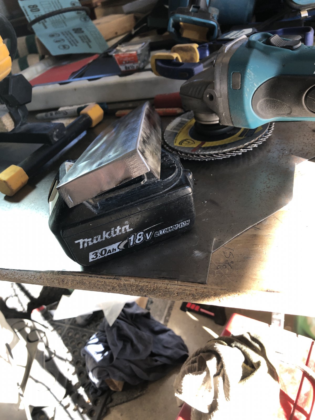

Did the cut and butt where you over lap then cut at an angle. This way when the panels close the gap gets smaller. Got it off a video. Worked well. My pic of the cut off wheel is exaggerated,about a 30*worked good.

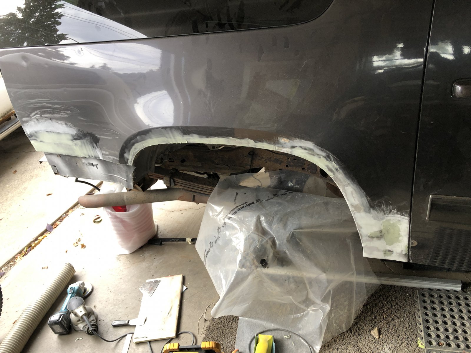

Sanding bondo sucks.

Working on this while bondo cures.
The bondo project. Have a high spot in the metal on the lower left. Tried beating in but didn’t move its right on bead right Where the backside is welded. I think I have to grind it down.
