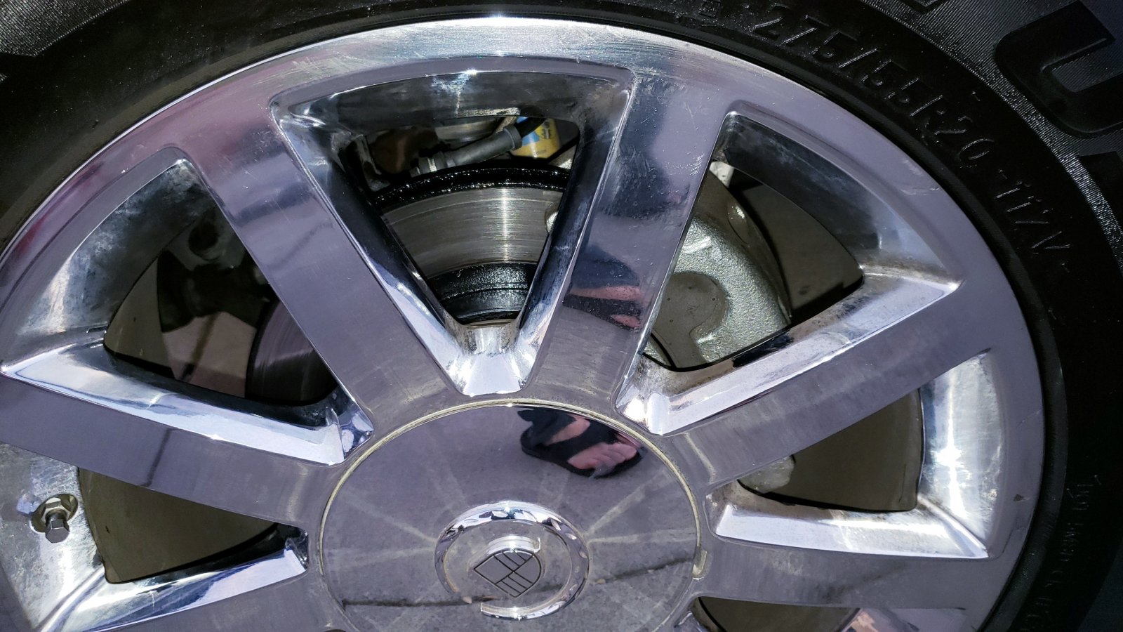

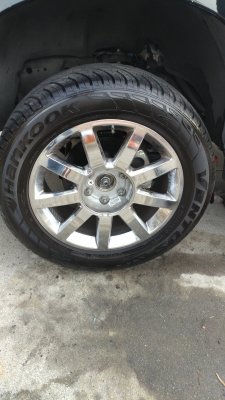

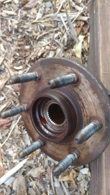

Finally got around to replacing my drivers side wheel bearing. Wasn't making any noise or sloppy but figured it was time. Nearly 200k miles now.
Forgot my other pics
Edit: these are nnbs front brakes btw. 13" rotor 20" oem esky platinum rims
20191116_152613.jpg 20191116_160924.jpg 20191116_160409.jpg 20191116_160944.jpg

I always get a couple people crying about paint on the rotors. It's gone after break in.
Yes my wheels are dirty... it's a kid hauler not a show truck. I'm lucky if it gets the softball field dust rinsed off of it twice a month lol.

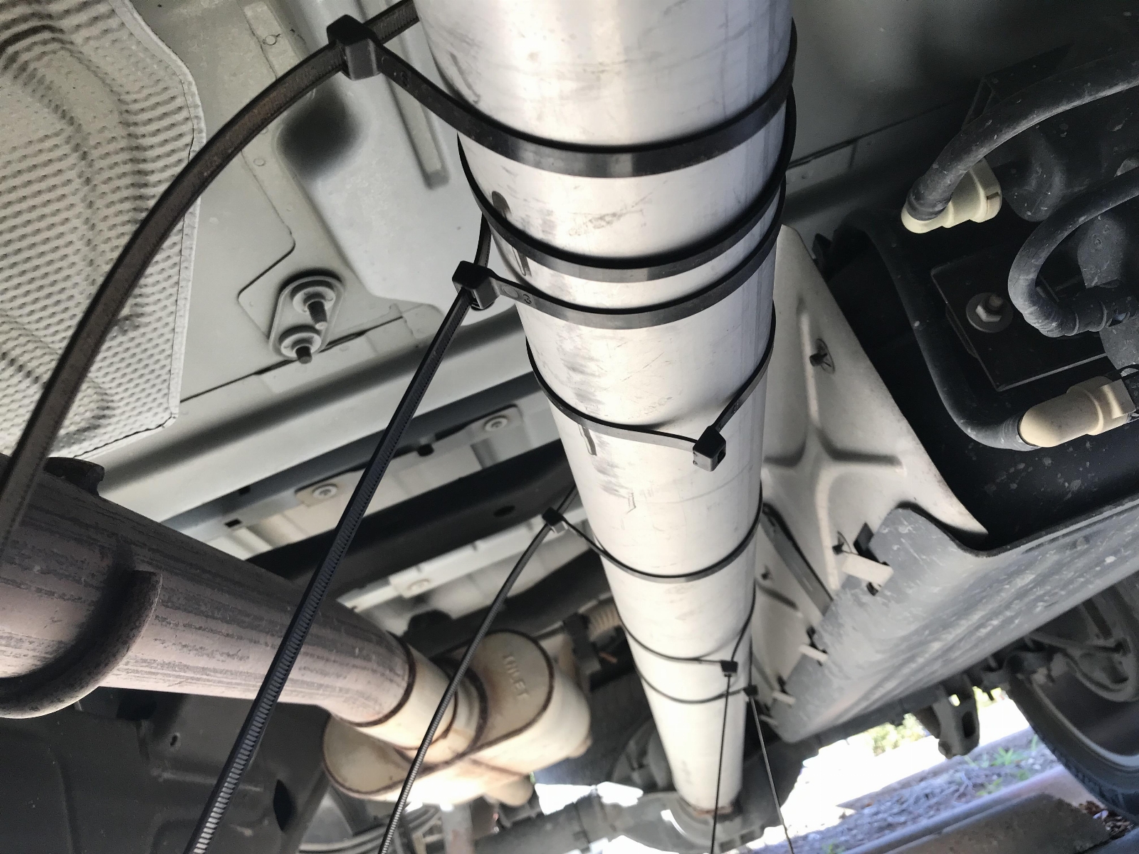

Well, damn. Maybe someone is pranking you with the ol' zip-tied driveshaft trick.
