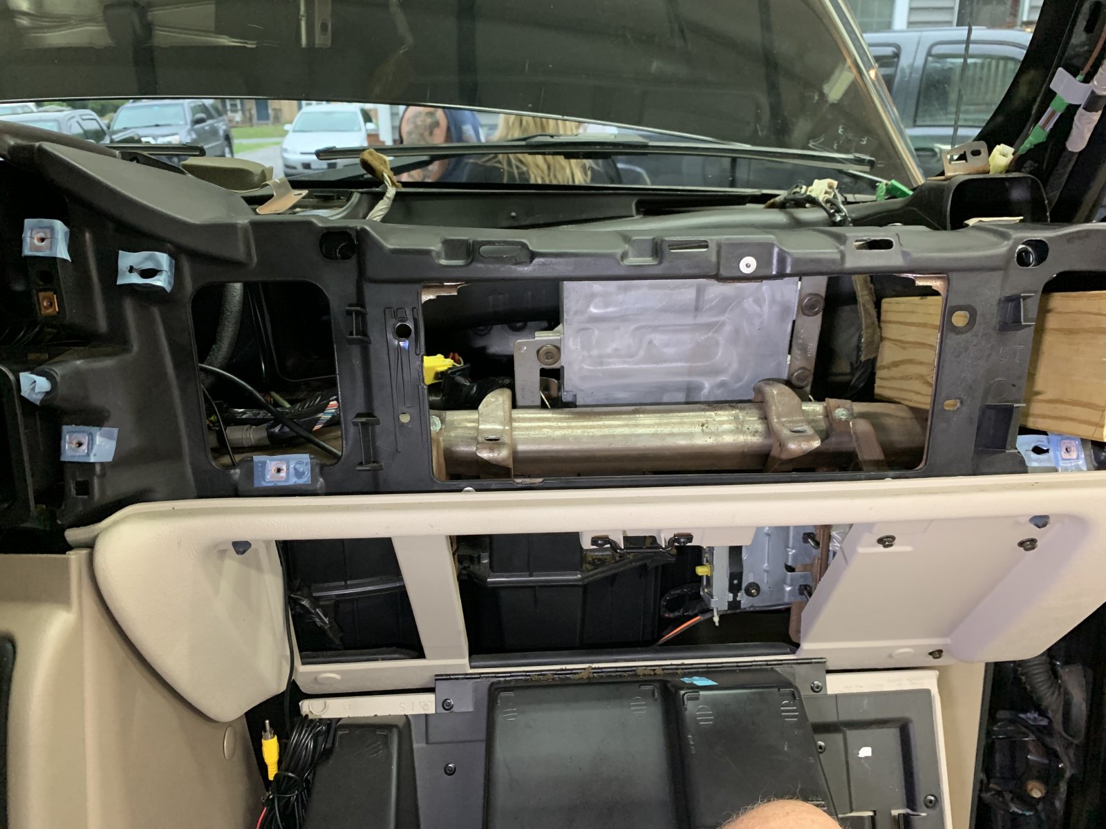

Got it all back together!!Got the Recirc. door actuator replaced. PITA. Still need to put dash back together in the morning, but everythings working. Didn’t end up needing to cut duct. Removed dash cover and airbag along with Onstar box. See 2nd pic with 2x4 raising duct just enough to get hand in there. Barely.
