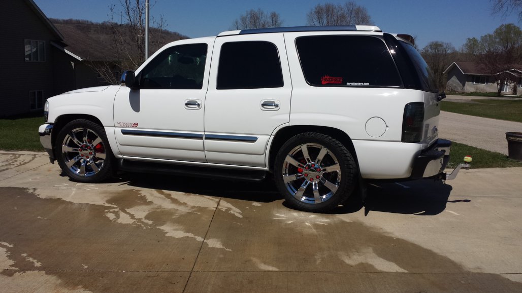

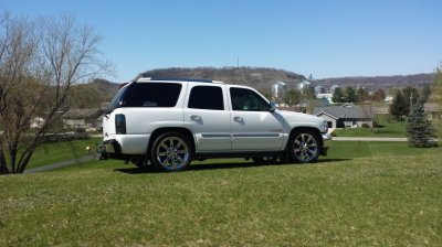

4 hrs of detailing today. Much needed because it gets driven sooooooooo much[emoji57]

Lookin gooooood!
....and that's what a green lawn looks like! Take notes @jdpber

Thanks Cob
And @ jdpber aint got nothing on my lawn!!!![emoji51]

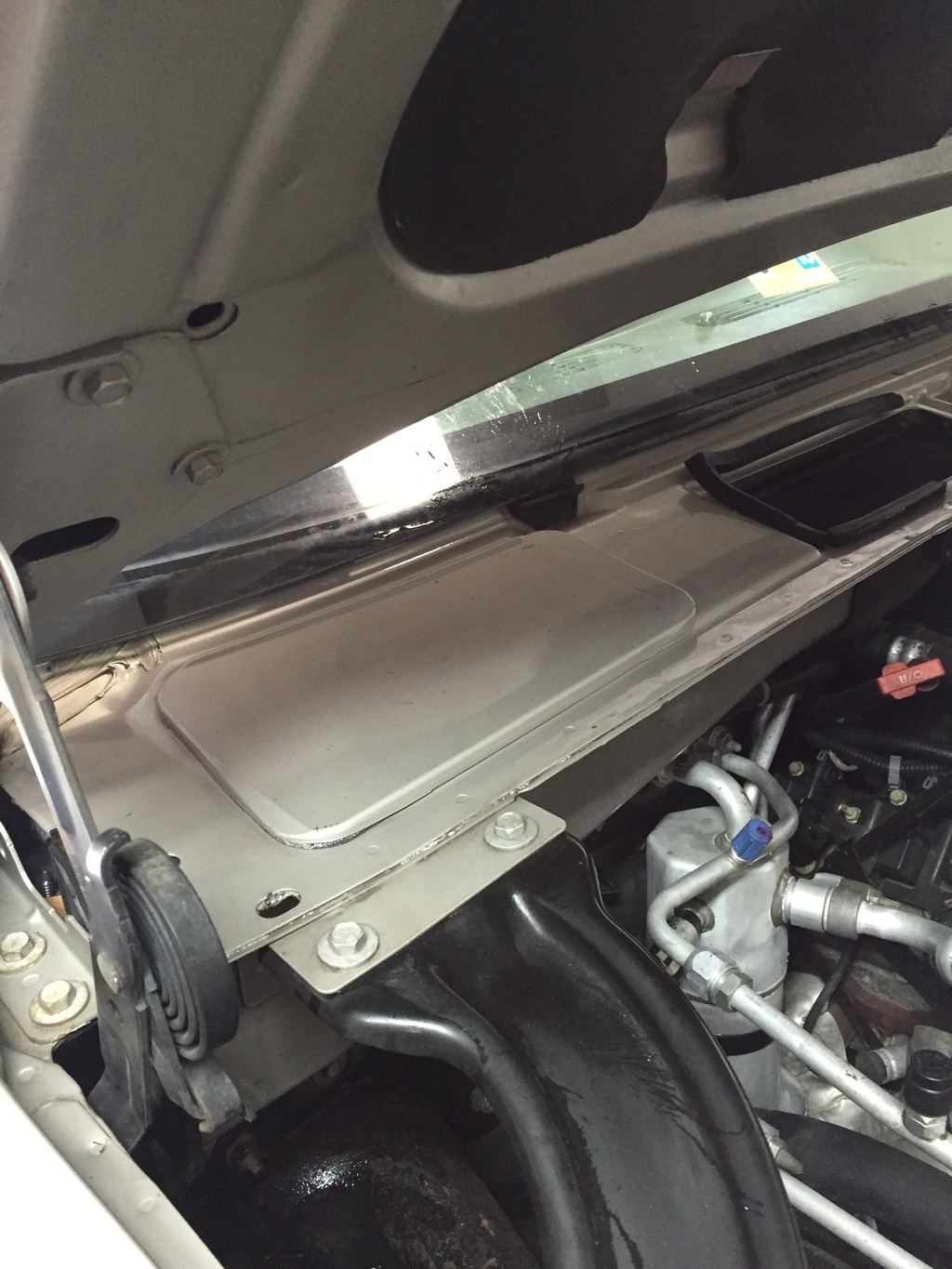

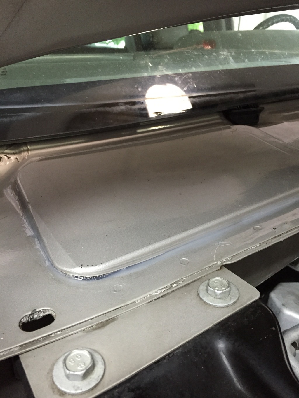

Did nothing to mine today except dial in my correct speed on my Scangauge with my 33" tires (+7% if anyone is curious on Speed adjustment in advanced settings) but helped my buddy on his 05 Yukon -
He kept having soaked front passenger floorboard and we easily found the culprit, it was a piece under the wiper cowl, the seal had given out on the access panel to the fresh air intake area, if anyone is having this water problem it can be a myriad of reasons but in this case this is what it was - just resealed it - good to go now
From inside the cab near floor board looking up:
New WEATHER STRIP for the heck of it
THIS IS WHERE WATER WAS GETTING BY - This sits directly over the screened fresh air intake, leading water straight to you box and into your floor board
